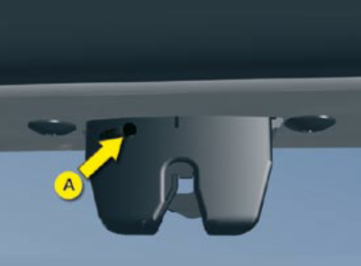

In order to open the tailgate, you'll need to follow this:
Fold back the rear seats to gain access to the lock from inside the boot.
Insert a small screwdriver into hole (A) of the lock to unlock the tailgate.
Push the white part, located inside the lock, to the left to unlock the boot.
