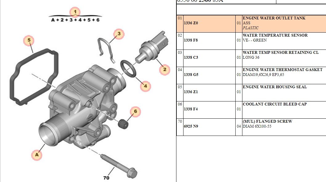

So is this looking like the sensor, or the thermostat? How do I determine which thermostat would be required? looking on one of the online dealers it lists 3 different ones with no way of telling which is fitted.

The temperature sensors normally fail safe & tell you that the engine is overheating when it isn't. Best way is to get it on live data on diagnostics & check out the coolant temperature. Even the cheap ebay ones will read coolant temp.
What is the last 8 digits of the VIN?

Just want to check that VIN is correct, your location says Spain but this is originally a UK vehicle?
Looks like the thermostat come with the housing. £113 + vat in the UK.
