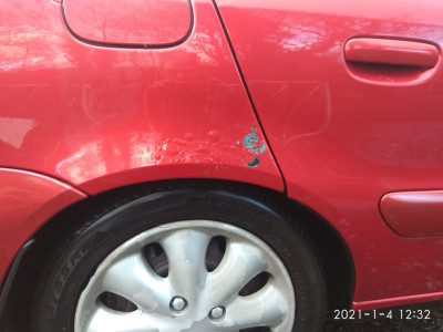

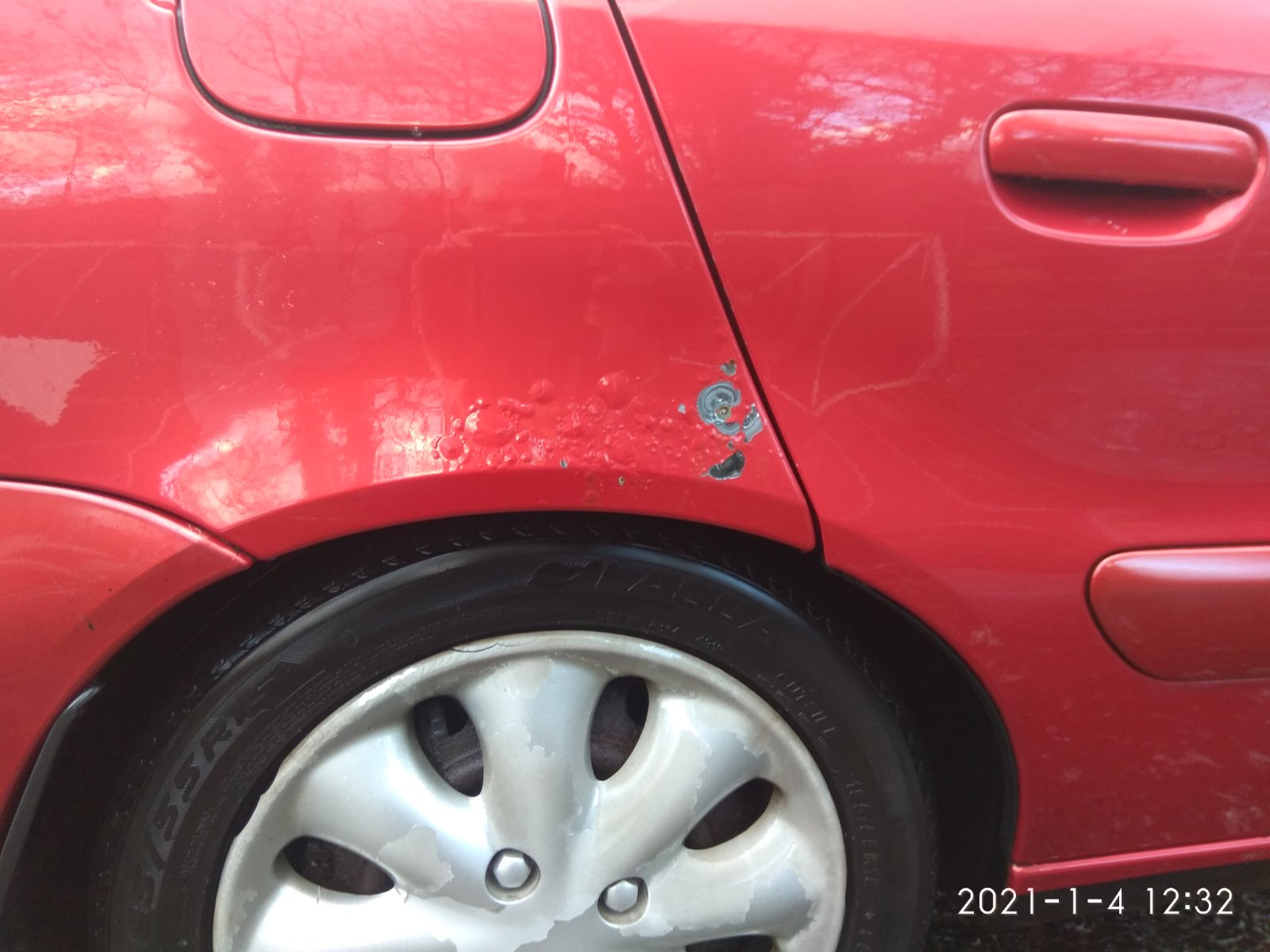

What is the process to remove this?
Got rust bubbling on the rear arches - both sides, but predominantly on the rhs.
Can it be grinded back and sprayed or does the affected area need cut out and replaced?

I think you'll only find this out when you rub them back and see what condition the metal is in - with a bit of luck it may be some moisture under the paint. Treat the metal with some rust converter, but wither way you'll need to prime, paint and lacquer regardless - but if it's over a lot of the arch it may easier to do and be less noticeable after with a larger area to spray - trying to blend in smaller dotted areas with original paint is a nightmare - better to have a larger surface IMO.

Well it flaked off when washing. Hopefully I can get away with a just working that patch. Just worried that paint matching will be an issue as the original paintwork is now 20 years old.

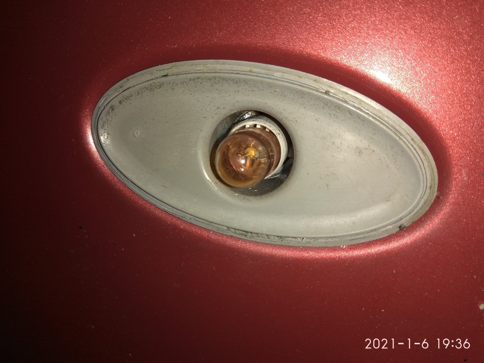

On another issue, how are indicator lens on the wings held on? Seems like they need glueing to hold in place, they don't snap on - I disbelief see anything fall off when I went to change the bulb.

Do you mean the little oval repeaters on the front wings? They're held in place by the springiness of the plastic at one end. You remove them by trying to slide the body sideways to compress the plastic spring and this then allows the opposite side to be manoeuvred out, followed by the side with the plastic spring.

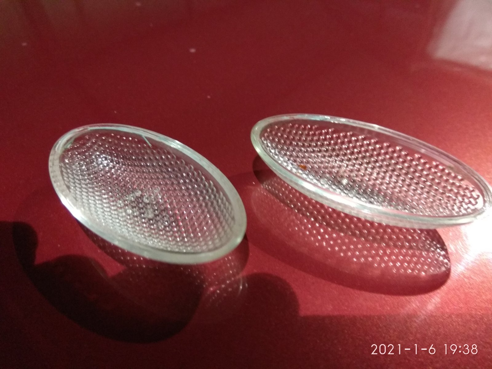

Tried that but didn't work. Has a bit broken off these?

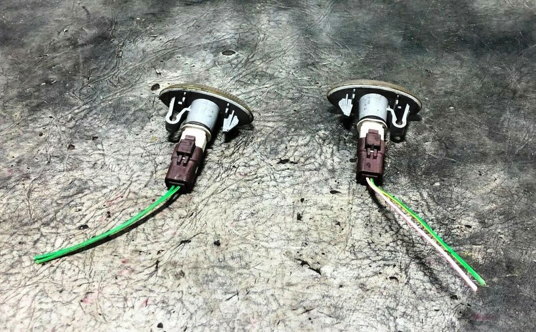

Yes, the clear plastic has broken off the base. You might be able to glue it back on. I "borrowed" this pic from Ebay and cropped it a bit. You can clearly see the plastic spring. You have to slide the backplate against that spring and then you can flip the other side up and then fiddle the whole lot out.
These units have had their wires cut for speed of removal. The plug doesn't take much longer to disconnect on your own car.

Thanks - what I hadn't realised was that these indicators are supposedly sealed units and instead of replacing the bulb, you replace the entire unit. I'll just be gluing these lenses back on.

I don't believe they are sealed units on a Xsara. I think that, once the units are off the car, the base can twist to allow the orange bulb to be accessed and removed. Just make sure to tie a length of string to the cable first, just in case it should drop back inside the wing. This ebay link shows multiple images of the side repeaters;

Ahh - see how they work now - I didn't take the base off so I didn't realise they were access from behind.

That's exactly it. Remove the plug and then you can take the bulb holder out of the backplate.Hell Razor5543 wrote: 07 Jan 2021, 12:00I think that, once the units are off the car, the base can twist to allow the orange bulb to be accessed and removed.
An extremely good idea!Hell Razor5543 wrote: 07 Jan 2021, 12:00Just make sure to tie a length of string to the cable first, just in case it should drop back inside the wing.
