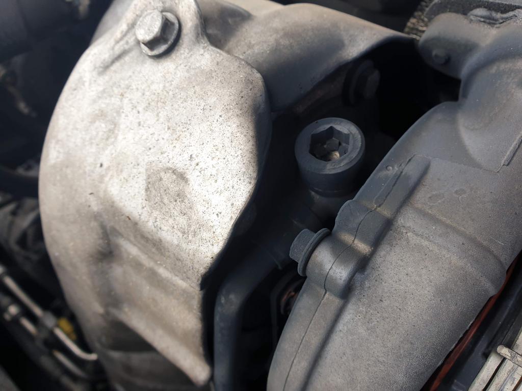

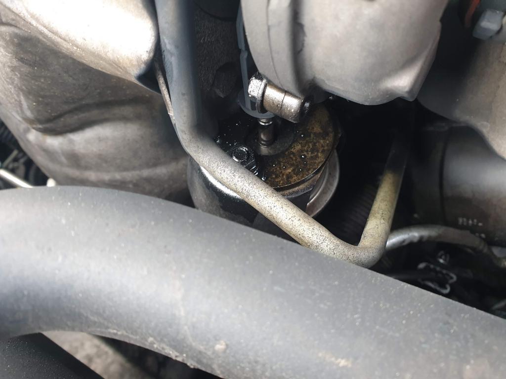

I got a new battery yesterday and the mechanic where I bought it from (it's a chain of autorepair shops that are abundant in this corner of Europe) told me that my turbo was about to pack in for good and I should get it changed ASAP. However, I'm always suspicious of mechanics from these places as I keep getting, how should I put this, erroneous advice from them. When my Volvo s60 was 7 years old and had 80k miles, one such mechanic said my clutch was on its way out (did another 80k with same clutch before I changed it out of prevention). And there are more instances but I won't go into it here.
Here's what the turbo looks like:
There's a bit of scorching above and some oil has dribbled out below, but I want to make sure I'm not being hoodwinked. No clouds of blue smoke are coming from the exhaust, though a dodgy turbo would explain the Depollution Faulty warning I get when I give the engine some beanage.
Any thoughts would be thoroughly appreciated.

Does your engine have the particulate filter.
Are you sure it's not the FAP system clearing itself out?

moomoo wrote: 17 Dec 2020, 17:10 Does your engine have the particulate filter.
It's a good question, but I had the particulate filter removed and cleaned last January. Then again, I do more city driving than I would like, and I know that's terrible for filters.

citroC5 wrote: 18 Dec 2020, 09:20...I had the particulate filter removed and cleaned last January.
Did you reset the ECU to reflect this using Diagbox or a high end generic reader? If not the ECU will still think the DPF is full.

This is just a hunch, assuming the vehicle in question is the 2008 in the OP sig then i would say that the vehicle itself believes the DPF has or should be at end of life and will throw up the fault so when you take it to Citroen Dealers they replace it.
Get it on a Lexia and inform the car it has been cleaned/changed.
As for the Turbo probably not on its last legs but they do suffer from lack of regular oil changes .

admiral51 wrote: 18 Dec 2020, 20:10 This is just a hunch, assuming the vehicle in question is the 2008 in the OP sig then i would say that the vehicle itself believes the DPF has or should be at end of life and will throw up the fault so when you take it to Citroen Dealers they replace it.
Colin
Thanks, Colin, good to know. I think I will have to finally invest in a lexia kit. I was hoping it wouldn't be necessary, but given the car's age and mileage (closing in on 180,000 miles), and given that I intend to keep it for as long as I can, and if I replace it I'm getting a c5 X7 tourer but with a 2 litre engine, it's probably a worthwhile investment.
