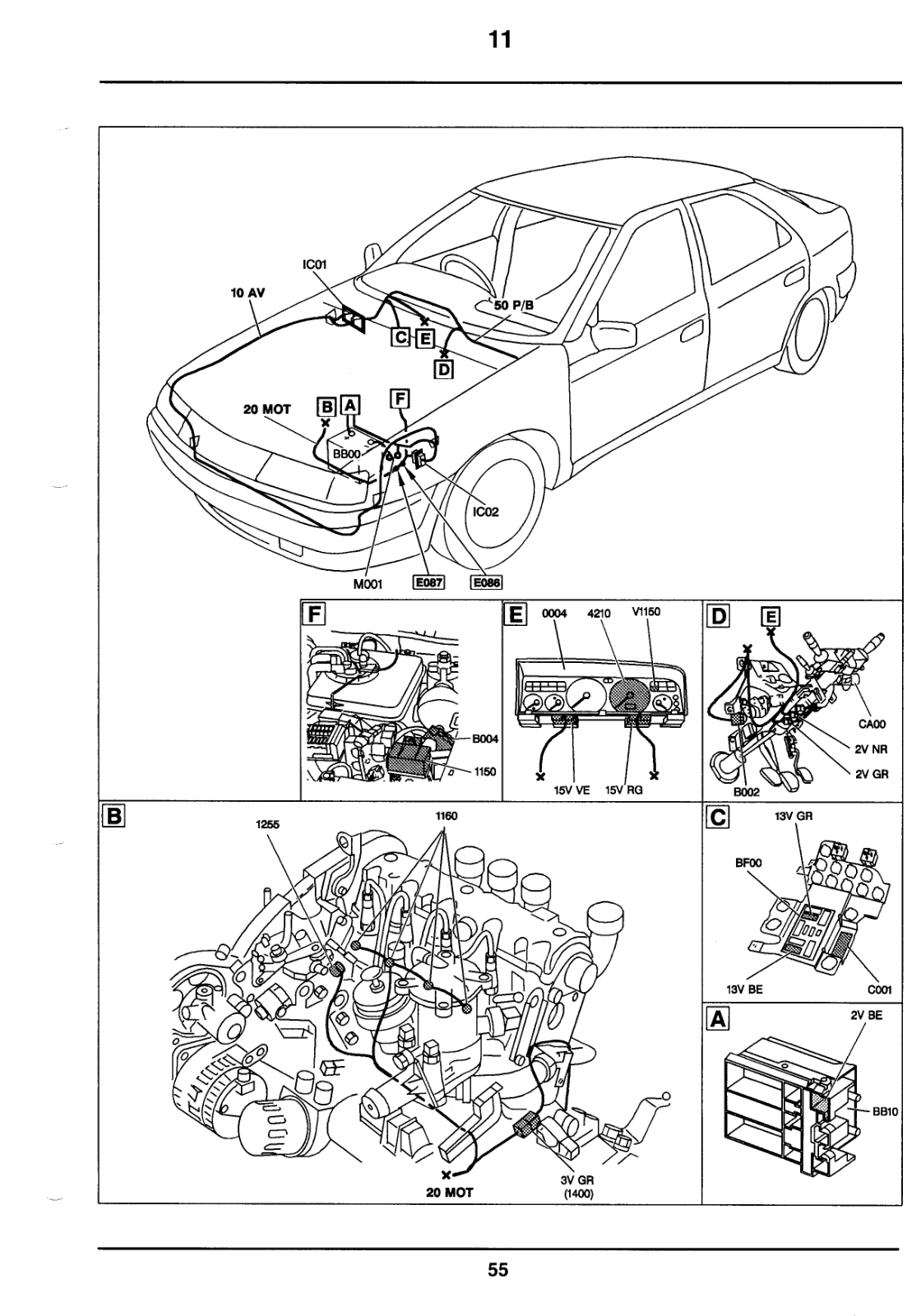

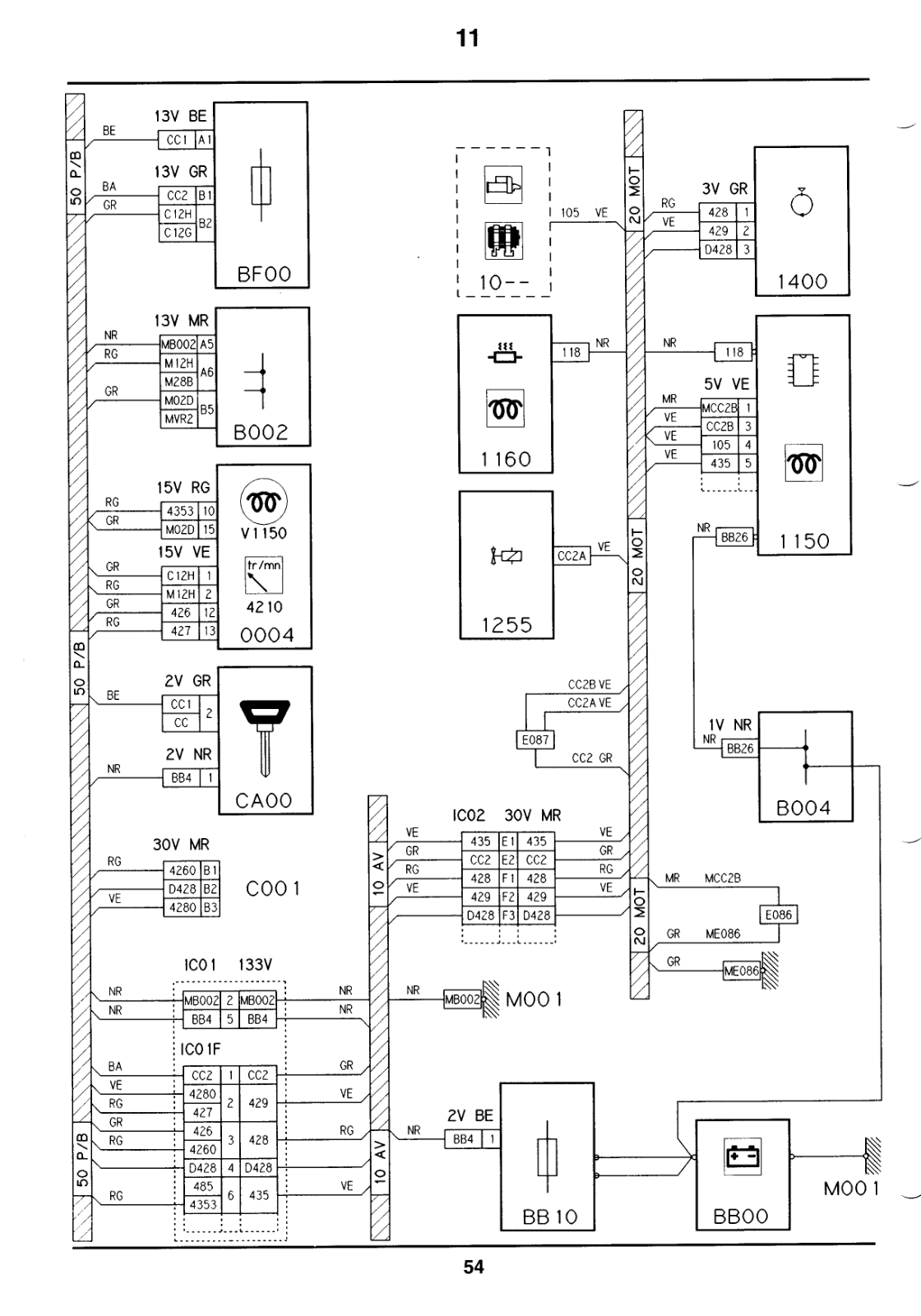

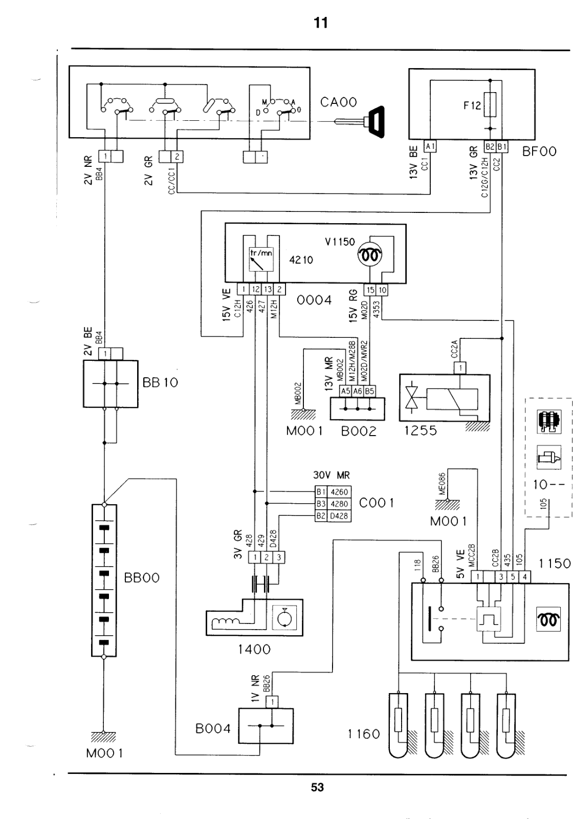

Here are the wiring diagrams applicable to your car 1255 is the Bosch pump:
There is also a chance that there is a faulty soldered joint in the fuseboard (BF00) under the dashboard.

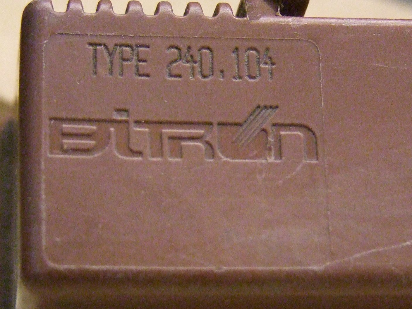

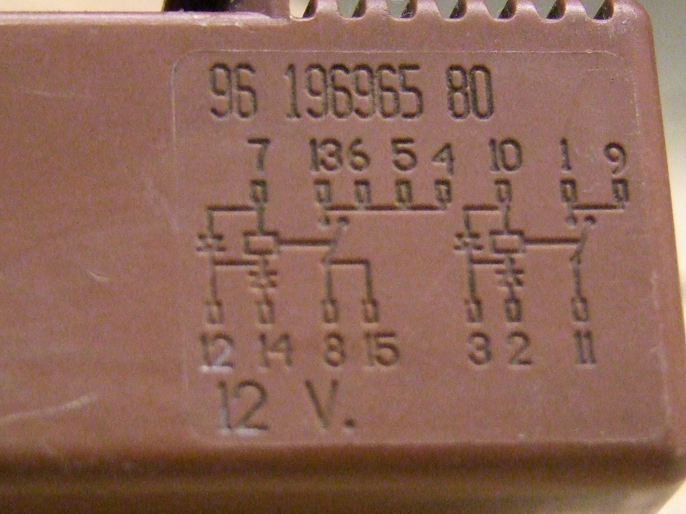

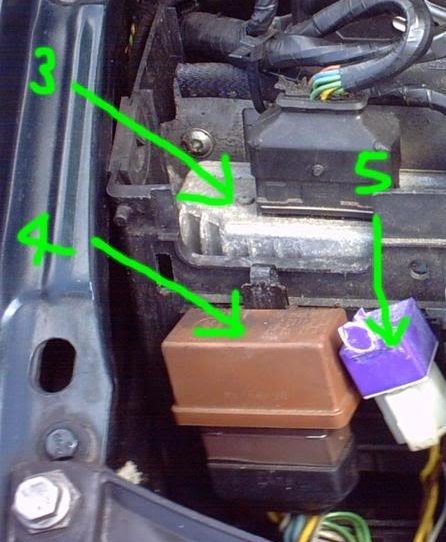

The Bitron double injection relay is part no. 1920 3X, and still available from Citroen.
It is fitted to dozens of petrol and diesel models.
I had to get a new one recently, and it carried the type number 240.101, brand Omron.
Unless you are adept with electronic repair, they are best simply replaced. I think they're around £30.
This is what the item looks like (#4 in the photo)...
Type number might vary a little. This is an old one...

Are these injection relay's all the same? i would have thought they'd be different particularly between petrol & diesel engines, the reason i ask is i spoke to my local parts dept this morning, he gave me the same part number (19203x) and told me it was no longer available. Now i can sort of understand that if it were specific for my car (with it being old/rare now etc) but if it's the same relay used on many PSA vehicles then something is a bit suss regarding why i was told it's not available :?: Anyway... todays proceedings has included a good prod around the pre & post heat relays mounted besides the underbonnet fuse box = no power to them, we replaced the ignition switch and the car came back to life, the fella working on my car (a very knowledgeable man :) ) then started putting the car back together but it spat it's dummy out again & packed up! but on generally moving the fuse box, 1, he came across some scotch block connectors :shock: & 2, disturbing the fuse box brought the ignition lights back to life, tomorrow all being well it'll be getting a replacement (under dashboard) fuse box & a general wiring check in that area.

There seem to have been a good few variants on the Bitron 240.1xx injection relay, with Parts listing different types for different vehicles. Essentially, they all appear to contain the same two internal relays, but the fitting of two of the diodes, and some other inter-connection of the pins, does vary, depending on whether the car has an immobiliser system or not.
The part number 1920 3X I quoted above is the one currently listed for a Xantia 1.9TD, and is shown as available. It is unlikely to have been superseded, so just insist that they order it, if you still need one.
The only reason I mentioned the 240.101 is that, in the case of the XM2.5TD here, when my dealer accidentally destroyed my relay, a listed 1920 3X was ordered up, and the Omron-branded 240.101 was supplied, fitted, and immediately worked.
The part is listed, so ask them to go with it, or provide its possible replacement/equivalent. It's annoying when dealers parts departments respond like this. Some are just lazy, it seems.

Chris, This car has a mechanical pump with no electronics and no injection relay, just a wire from the ignition switch to the pump. Take a look at the diagrams that I posted viewtopic.php?p=667533#p667533
