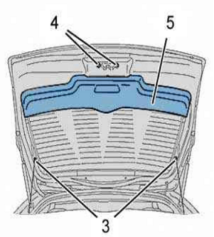

Re: Removing Citroen C3 number plate bulb assembly
So if you lift the tailgate up, you'll need to remove the plastic Trim (5) which is secured by panel clips:

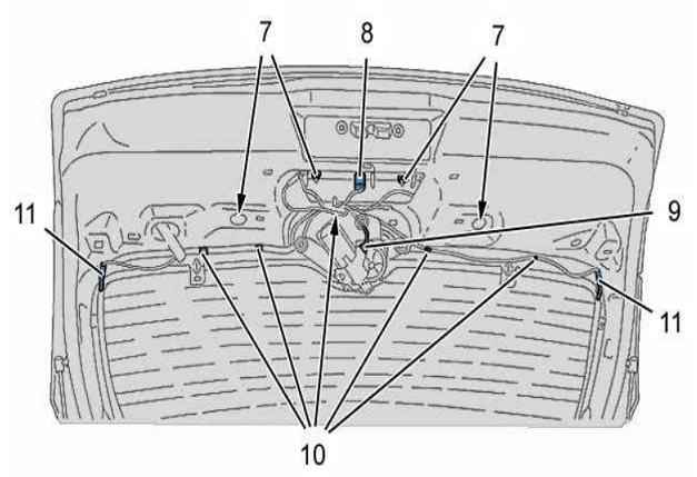

Then you will see the following, where you should be able to access the clips and connectors:
The clips and connectors for the number plate lights are here:
Thanks, that is just what I needed. I thought the trim was secured with clips but without knowing you do not want to pull too hard as I don't want to break.
