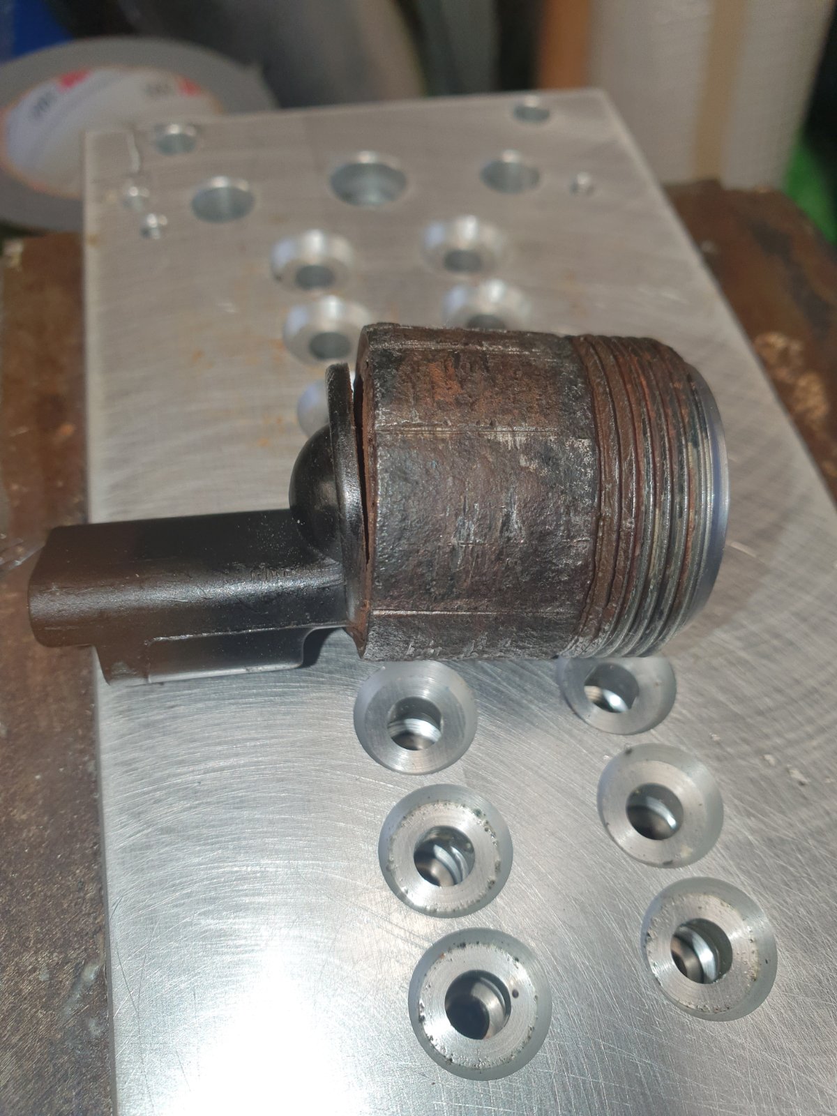

Update: This morning I took off the firmness control solenoid and found the actuator pin to be sticking as though the tube it slides in was no longer round.
The solenoid cap looks deformed so maybe internal corrosion is slowly crushing the tube?
This would explain the sudden changes in height and the dropping overnight as the solenoid pin controls the spool pilot needle.
I have attached a video and pictures showing the sticking pin and cap deformation.
Off for a trial drive now...

Re: C5 x7 2009 136hdi Hydro woes
I have just done 10-12 miles of jolt free magic carpet of old ride...
Its not far, But I was getting a jolt within a mile of home previously.
I ground the pin so that it moved freely up and down inside the solenoid coil on any position of rotation and then polished it. Obviously this is a temporary fix and I shall be on the lookout for a good used valve assembly or solenoid.
Thanks for all your help and hopefully I have found the solution.
