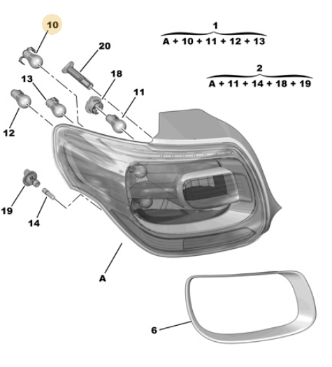

GiveMeABreak wrote: 10 Dec 2020, 21:39 Pop your VIN up for me so I can see exactly what you have fitted. That wills ave me some time. SOme cars had LED lookalike lighting - but were not actual LEDs.
You would likley find the parts for the pre-facelift lamps when searching by vin. I have always believed that the facelift lamps are all LED except indicator, reverse and fog bulb. But i might be wrong..
Added a picture of the pair i have installed on mine.
I will connect a scan tool to have a look if there are any new codes since last time when i get a chance. I had an issue with ESP flashing every time i was accelerating but that turned out to be a blown fuse for the ABS unit, this is also why it would be interesting to have a wire diagram to see if ABS unit is controlling the brake lights or sending a messed up speed signal or something which i think could point towards an internal fault with ABS/ESP ecu.
x 6945
Re: Citroën DS3 brake lights flashing while driving
We use PSA directly for the info - not some dodgy site :rofl2: so as long as we are talking about standard factory fit options as your car rolled off the production line it will be accurate.
So as I suspected your vehicle does not have LEDs - they are standard bulbs.
Lamps 10, 12 & 13 were never LEDs - only bulbs.
Lamp 11 could be either depending on market and build date.
Your VIN indicates that lighting option [1] was fitted to your car, which consists of: 10, 11 (bulb not LED), 12 & 13 which are all filament bulbs.
