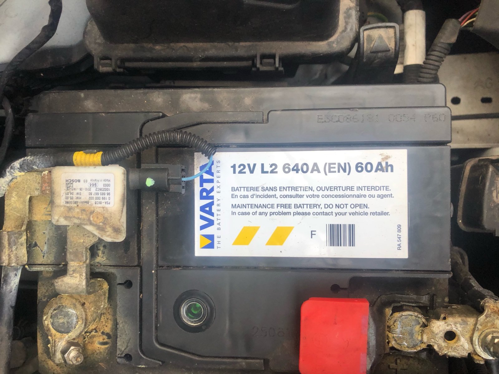

There will be a date code somewhere. Can you post a photo of the top of the battery and we may be able to identify it?

The only code I can see on the battery E3CO861810054p60.

It's usually shorter than that. Something like 0410 or 04/10. It may be printed on or it may be embossed into the plastic casing itself.

Re: Power steering failure
250610 which I'm guessing means it's never been replaced!

Took me ages to find it on the photo but, yes, it looks like it's a ten year old battery.
Time for replacement?
