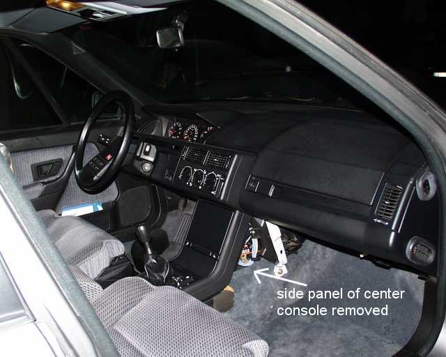

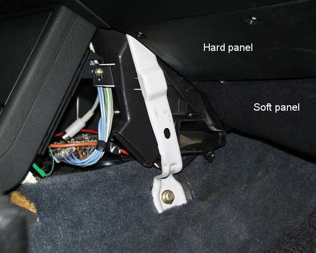

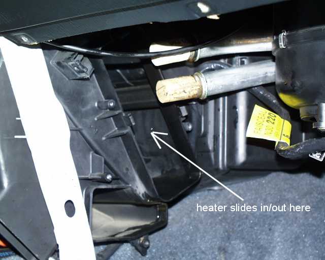

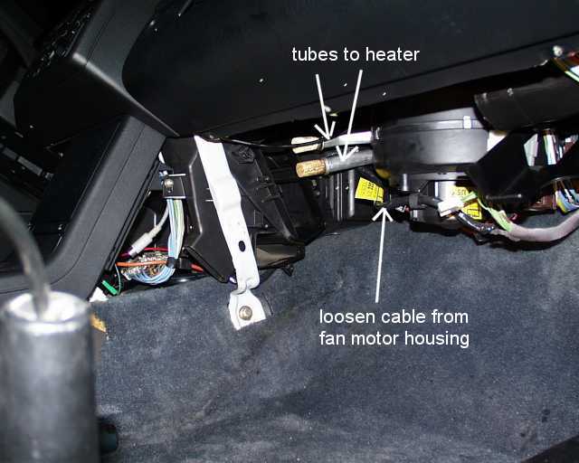

No need to worry you don't have to move the dash (usualy on other cars you have) but on this cit (XM) no...
Here are some pics...

Zega, your pics are excellant! nice one. :-) having made this matrix so easy to aceess (compared to ZX's) why on earth did they change the system?

Errm ---- Pictures are of an XM ---- but don't you have a Xantia Ade? If so then it's the dash out!
