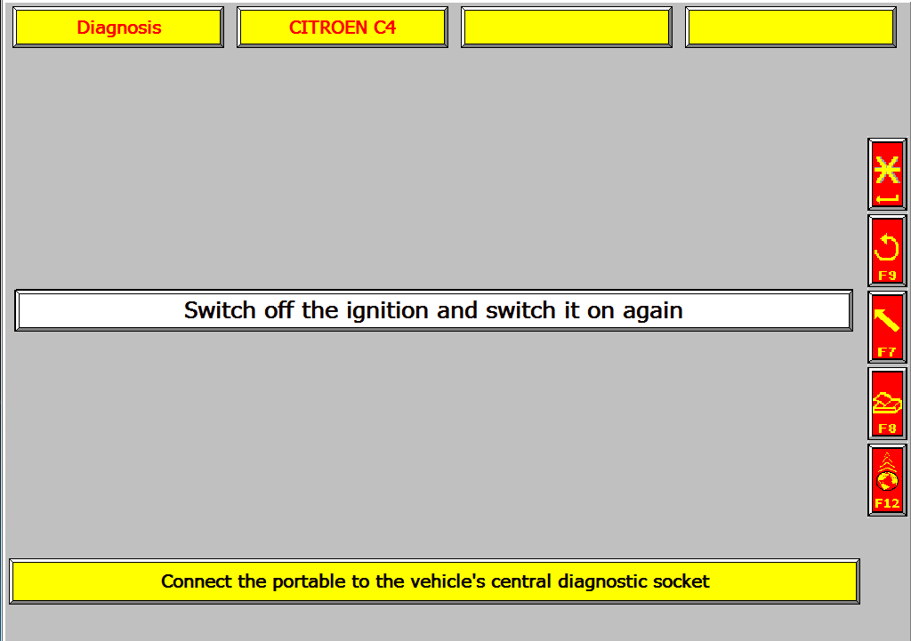

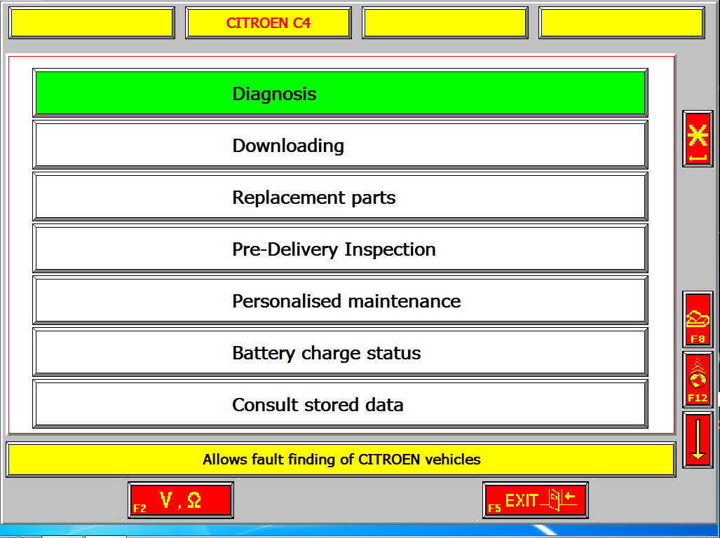

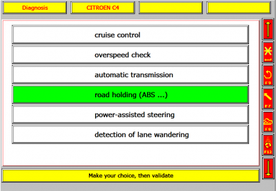

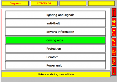

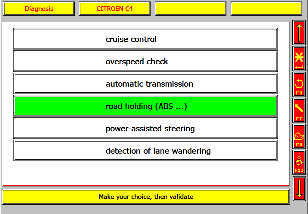

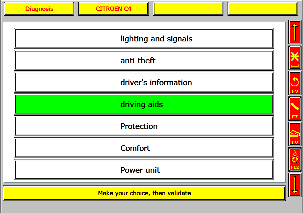

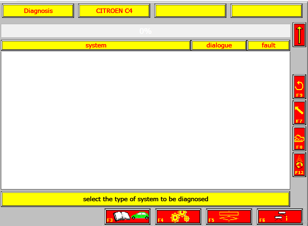

I started the engine and was driving 50 meteres and come the "brake fault" and ABS light on again...
When I try to take out fault code on the ABS nothing apear in the list, please see attatched photos below:
- Posts: 12583
- x 1487
Re: C4 (2005) - ABS light.
Try with Diagbox rather than Lexia. Is this a diesel or a petrol?

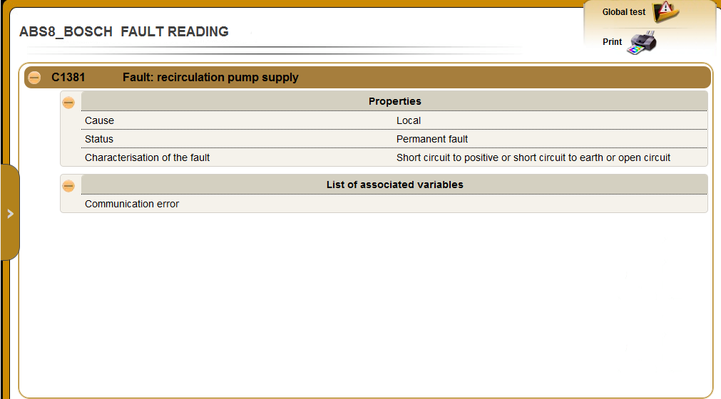

Thank you, then I found a error, but need some advise from you people how to deal with it...
As I have informed about these issue have been there for 3-4 years, when it occur in the start it was coming and going... and then it was present for long time, and den sundely it disapear... for a while... and not it has been stable on for long time...
I don`t know if these is telling someting about what can cause it?
When I`m googling it seems that many have had issue with the ABS relay? diodes?
- Posts: 12583
- x 1487
Post up the RP number of your car (on the door post sticker), and the details, and I'll see if I can find a wiring Diagram. I found one for about your age of car which shows 3 feeds - one via Fuse 7 on the underbonnet fuse box, the two others via maxi fuse 2 and 3 (which are under the fuse box). I would check that all these are intact first. If we can find a wiring diagram, then you can check for the presence of 12V at the ECU plug - but my guess would be the pump in the ABS unit has had it.....
