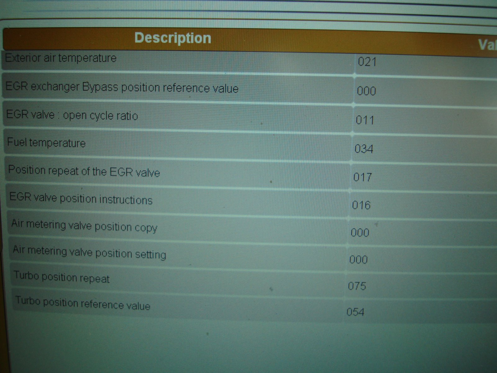

My 2016 C3 1.4 HDI DV4C cruse control trips out sometimes when climbing hills. I did a global test on Lexia and found P1497 and P2562 fault codes logged against the Bosch EDC17C10 R3 ECU. After clearing the codes, I did a live check of the air system and found the Turbo wastegate requirement drops from 99% to 54% soon after engine coolant temperature goes above 60C. The actual wastegate position also drops but only to 75% at static tick over.
The Turbo boost pressure follows this and drops below requirement as you would expect, however when decelerating the wastegate requirement climbs back towards 99% and the + 20% split of actual to required Turbo wastegate heads to zero, restoring Turbo pressure. This seems the wrong way round to me as I thought you would need Max boost on acceleration not deceleration! This low wastegate/Turbo boost pressure remains till shutdown and coolant drops below 60C which resets the wastegate requirement back to 99% and Turbo boost pressure meets requirement till again coolant goes over 60C.
I have checked the suspect areas listed against these fault codes in information on my old cloned copy of Citroen Service Box but can’t find anything relating to what changes at coolant temperatures above 60C.
Has anyone seen anything similar to this problem? Has anyone suggestions or information to pin down the cause as I have run over my knowledge level.
[attachment=0]DSC04363.JPG[/attachment]
UNUSALL LOW BOOST. P1497 P2562 HELP
