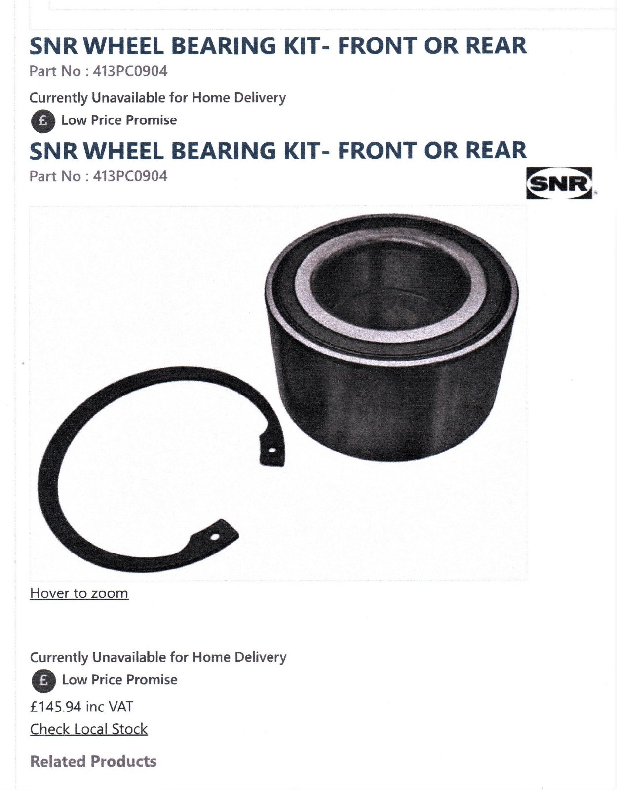

Re: 407 rear hub bearing replacement
Sorry Alvin I did not notice your location.
The Peugeot part number for the rear hub assembly is 3748.87. I suspect the Peugeot Dealer in Hong Kong would quote a ridiculous price ?
The SNR bearing part number shown here is 413PC0904, but that may differ with suppliers. It would certainly be cheaper for you, but you will need a hydraulic press and must be very careful not to damage the ABS ring.
Thank you for the info. I wasn't able to wait so I bought the complete assembly for both left and right rear. Thereafter, I felt my wallet a lot lighter than before.
