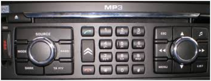

Re: 2012 C5 EXCL phone Bluetooth / sim card ?
In that case you must have the RT4 system below:

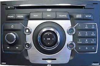

I'm surprised as that was one of the earlier telematics systems that were fitted in 2008 vehicles, but by 2009 they were replaced with the MyWay system, or the premium NG4 system pictured in my last post, then the RT6 came in later (eMyWay).
So if you have this vehicle it must be a late-registered model. The vertical slot is a SIM card slot, not an SD card. The SIM card is required to operate the internal telephone and of course for the emergency call and services functions to operate.
This model has no Bluetooth functionality, which is the reason why you cannot pair it. If you have the vehicle VIN number I can confirm all the factory specs and the actual build date, which can confirm the option you have. So I suspect this is a late registered C5 or more likely, the Head Unit has been changed by a previous owner with the RT4 system which as I said is an early unit only found on the first C5 X7s.

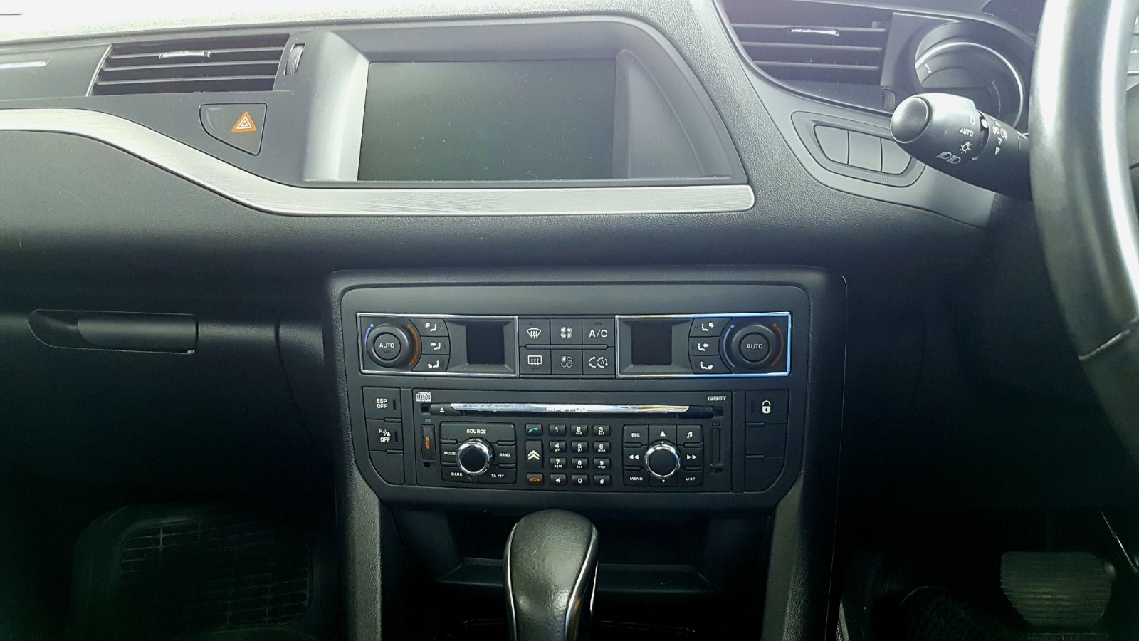

Thanks Marc,
Sorry for the delay. I appreciate your response.
Yes the pic you have attached is the system installed in my 2012 C5.
The car was exported to Victoria Australia. It is a C5X708 MY12 Exclusive HDi VIN: VF7**************[VIN obfuscated, can be read by forum staff]
I have now taken a pic and will attach.
I still love the car, the suspension is absolutely fantastic (even better than my 2005 C5 diesel) but it is a bit sad it has no blue tooth functionality.
The Hydropneumatic suspension of the Citroens will be sadly missed.
I anticipate my next car will be the last model of the C5 diesel namely the 2017. I hope a few of those were exported to Australia.
I will be looking for one in around 5 years. Thanks for your assistance.
Feel free to inform me of anything else I should know about the car.
Regards
Paul G Smart
