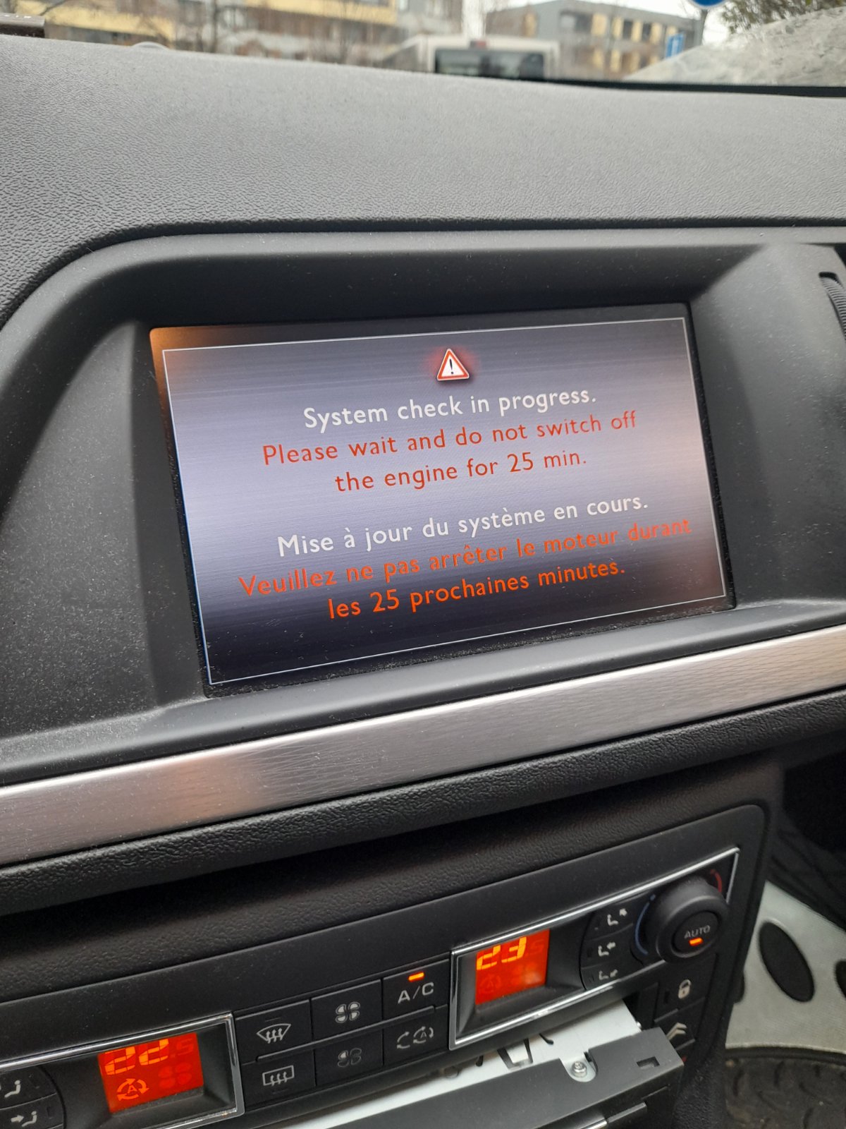

im kinda calling for help.. i have citroen c5 III with ng4 but one day on the lcd screen showed up "system check dont turn off the engine" or something like this and since then my ng4 doesnt work. It keeps showing this message and restart repeatedly. Park sensors not working, usb slots not working, radio not working.. and i dont know what to do.. i was thinking about trying reainstallig sw (firmware) but i cant find any actual link.

In the attachment there is an error message I'm getting with my old NG4.

Ok, so I have just checked out that message and there is a Technical Service Bulletin relating to that exact message.
Basically, the Flash Memory on the motherboard has been corrupted and PSA's solution is to replace the whole thing.
So If you have a spare NG4, you will need somebody with Diagbox that can code your vehicle's VIN into the replacement NG4 and then configure the specific options that will change the logo and ensure all the other options are correct for your vehicle.
