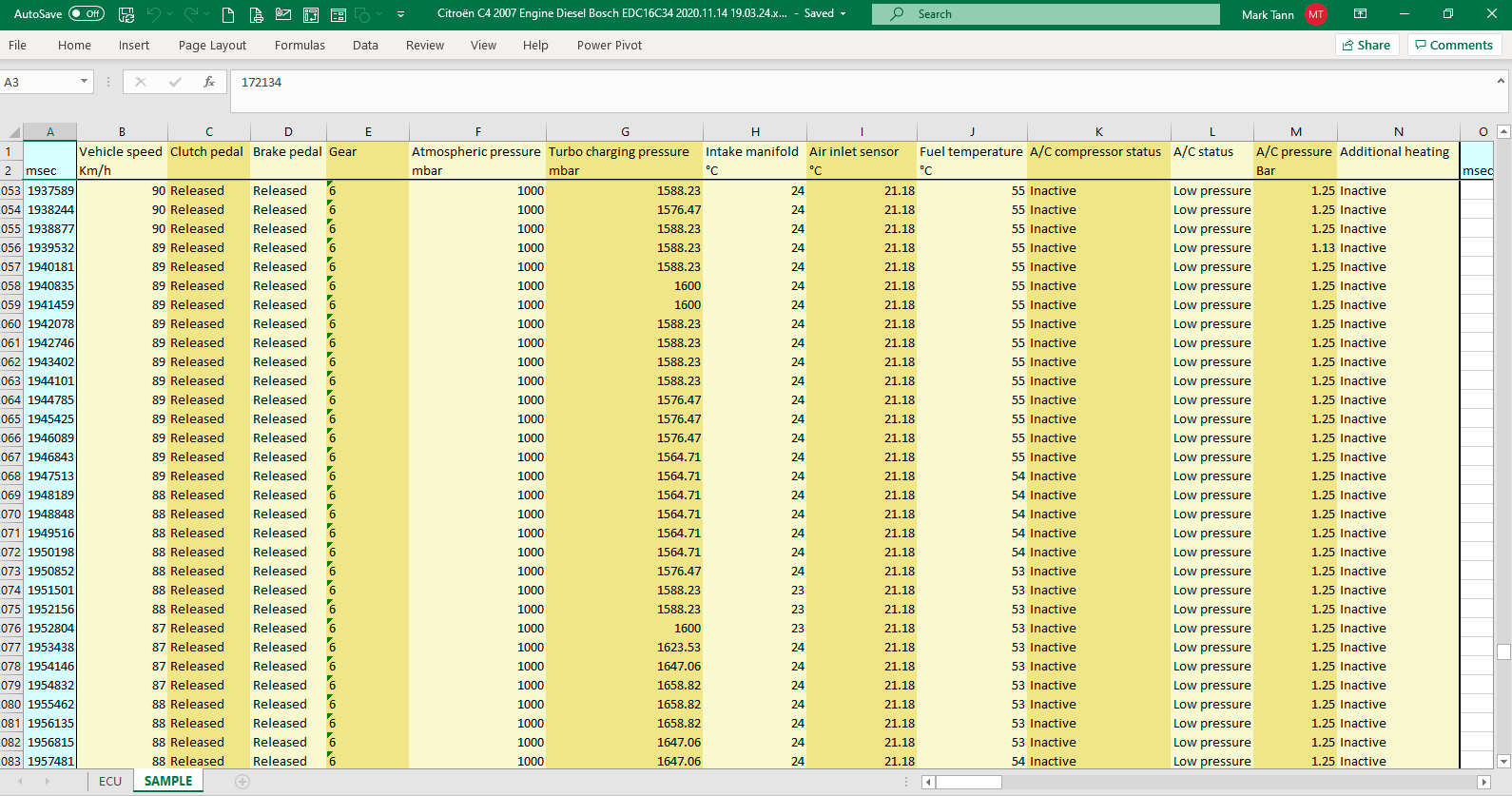

I did take the car out last night with my laptop connected, collecting live parameter data, including turbo boost pressure, air intake, solenoids etc etc.
Haven’t had much chance to evaluate the data as yet.

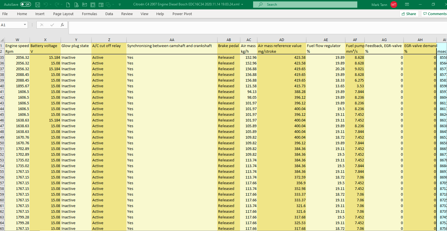

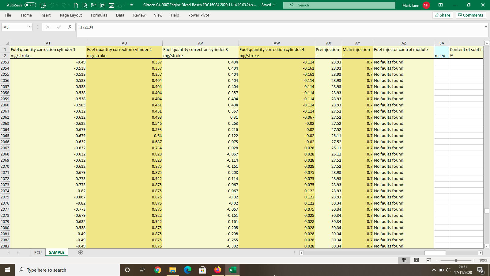

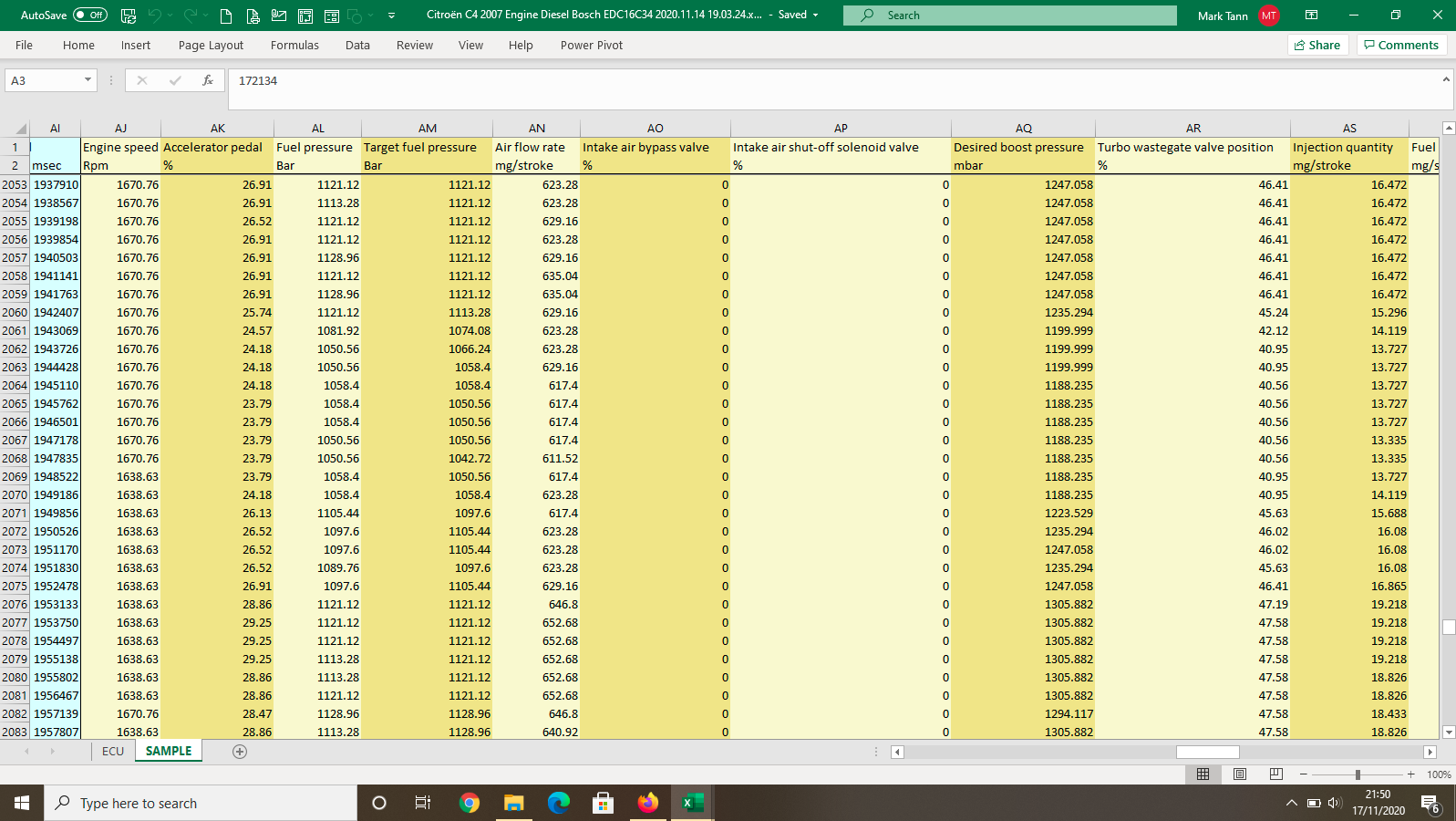

These are some of the values captured during the test drive, the EGR values recorded as zero throughout the 15 miles travelled.

So I cannot see anything glaringly obvious on the data, other than no reading on the EGR values at any revs / gear etc and a slight variance in air mass.
The EGR is quite new (Valeo) so I’m suspecting it’s a wiring issue. May try a BSI reset first unless anyone has any suggestions?
