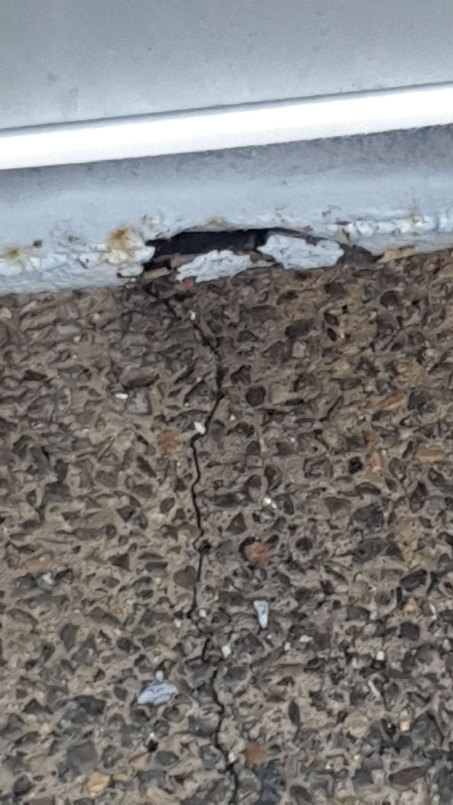

Hi ive just bought a Citroen xzara picasso
Its a lovely car ive i payer 700 for it however i have noticed today. That the door inder sill has a hole.in it didnt spot wen i bought it.
Does anyone know the cost of replacement or repair please as i cant afford to buy another
Picture attached
Under door sill replacement/repair

Re: Under door sill replacement/repair
That's a common problem on these - in fact that looks to me like it has already been repaired. If you only want it patched it will probably be around £100 / side. if you want a neat job with a new sill, much more...
- x 6945
My sister bought a set from the bay (links below) quite cheaply and the local garage fitted, primed and painted them in matching paint. Didn't take long at all, although the priming painting might be something you'd want to do yourself to save a few quid.
https://www.ebay.co.uk/sch/i.html?_from ... s&_sacat=0
