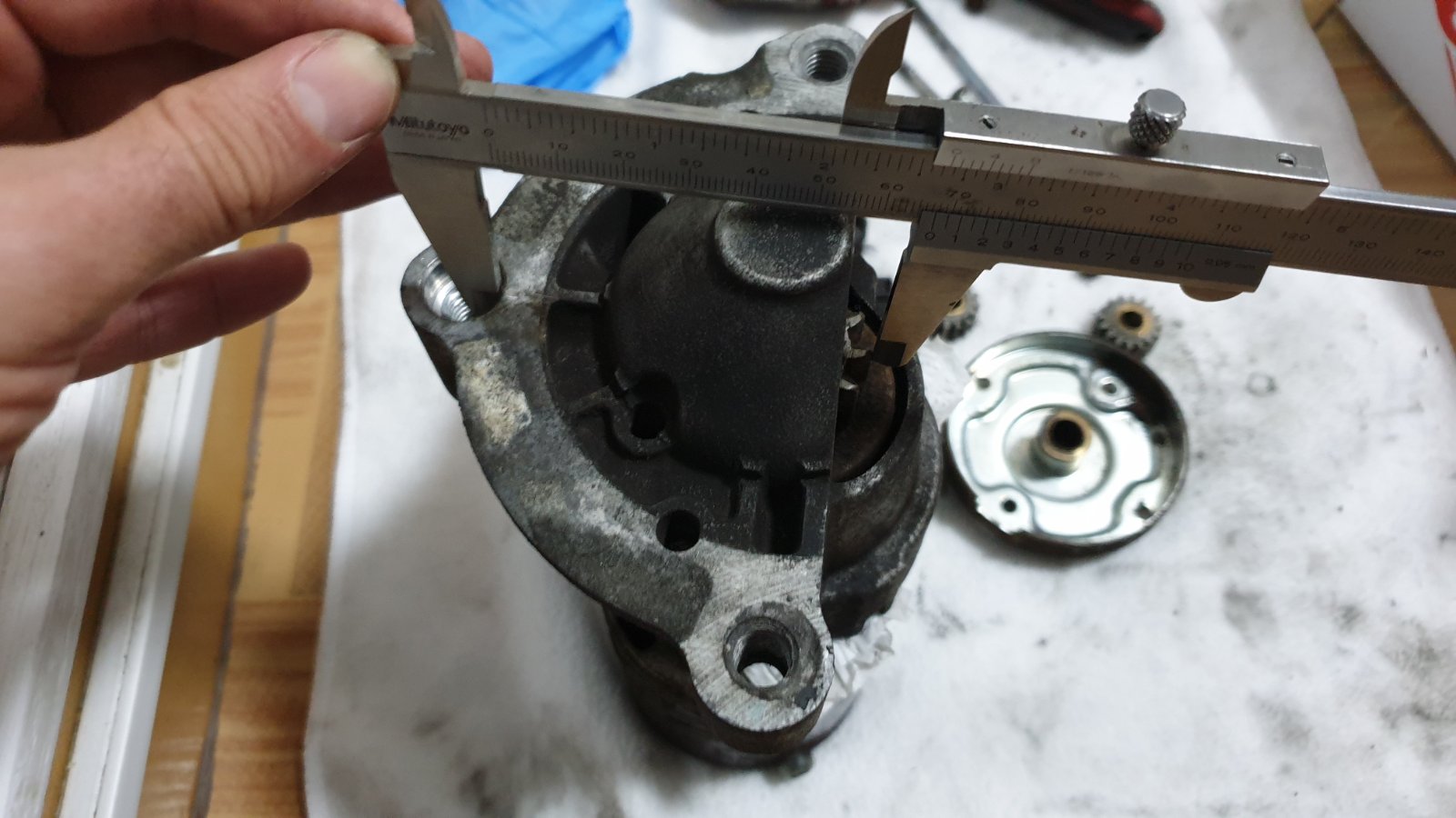

Hello all,

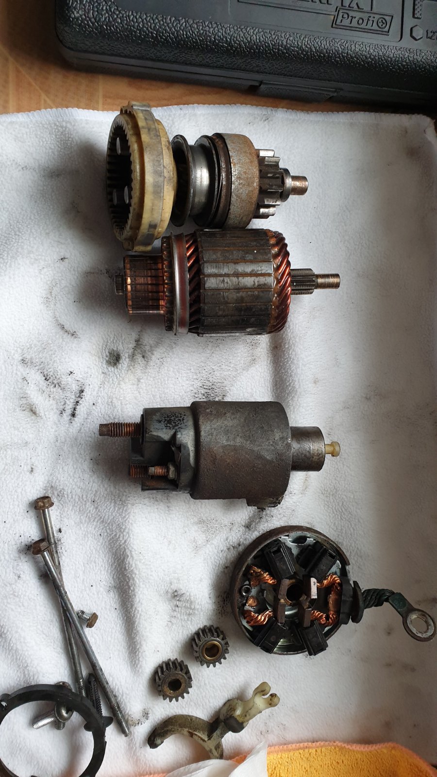

The original starter was showing sing of death. Dismantled completely and the only issue is at brass bushes.
I have ordered a new one from AS because now I don't have time to refurbish the original.

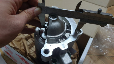

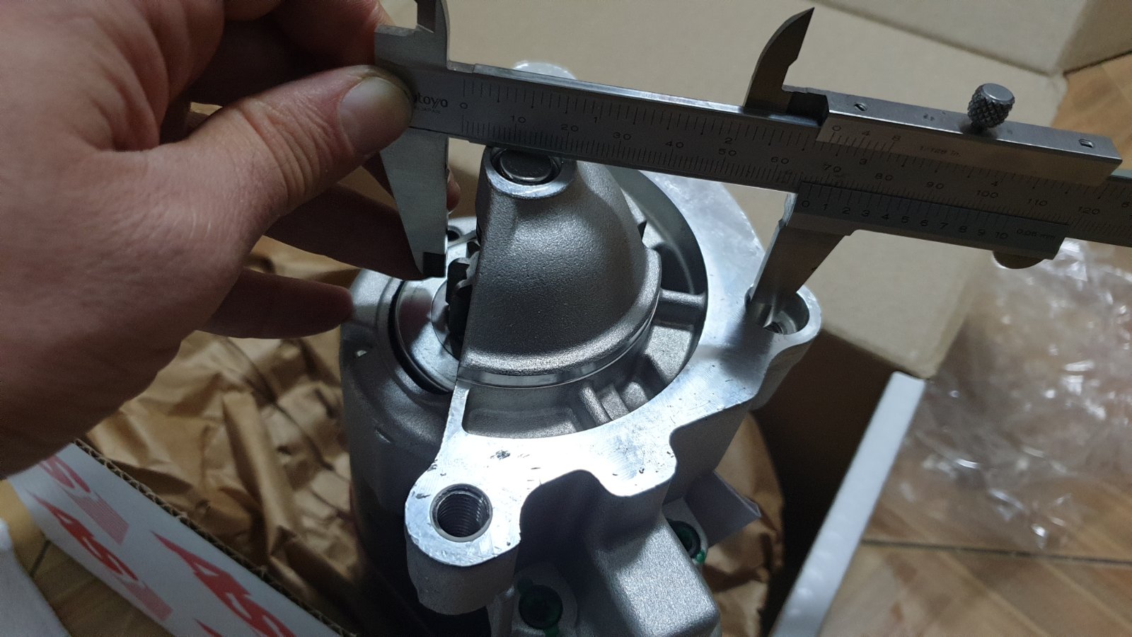

The problem is...or maybe is not :?: the original has 13 teeth and the new one only 10 teeth. I was ready to return it, but after measuring the distance between middle hole and the tip of the teeth I saw that is the same.
Should I return the starter?

Good news, the new one is working even if the different number of teeth because the shaft is deviated to compensate the smaller size of the gear This is not refurbished and can be purchased without old part. The new one is made by AS, series S0550.
Now the engine starts very very fast. I will search the bronze bushes for the original because all inside is good except the bushes.
