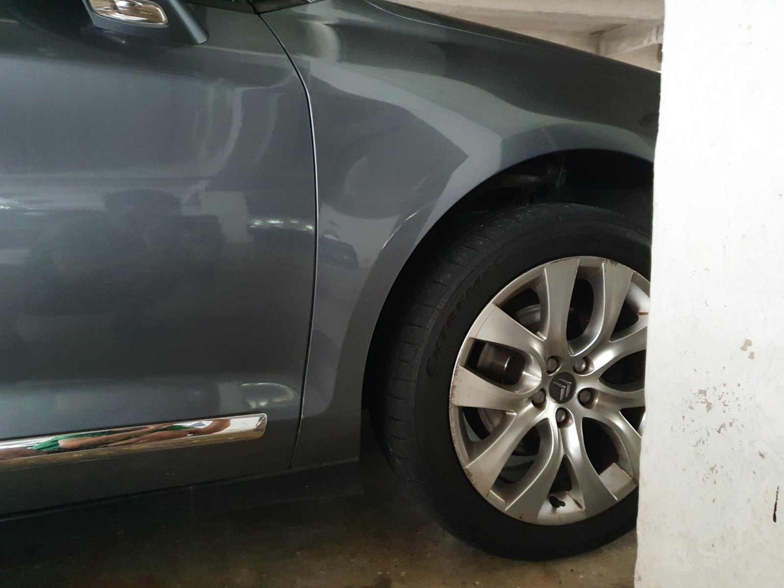

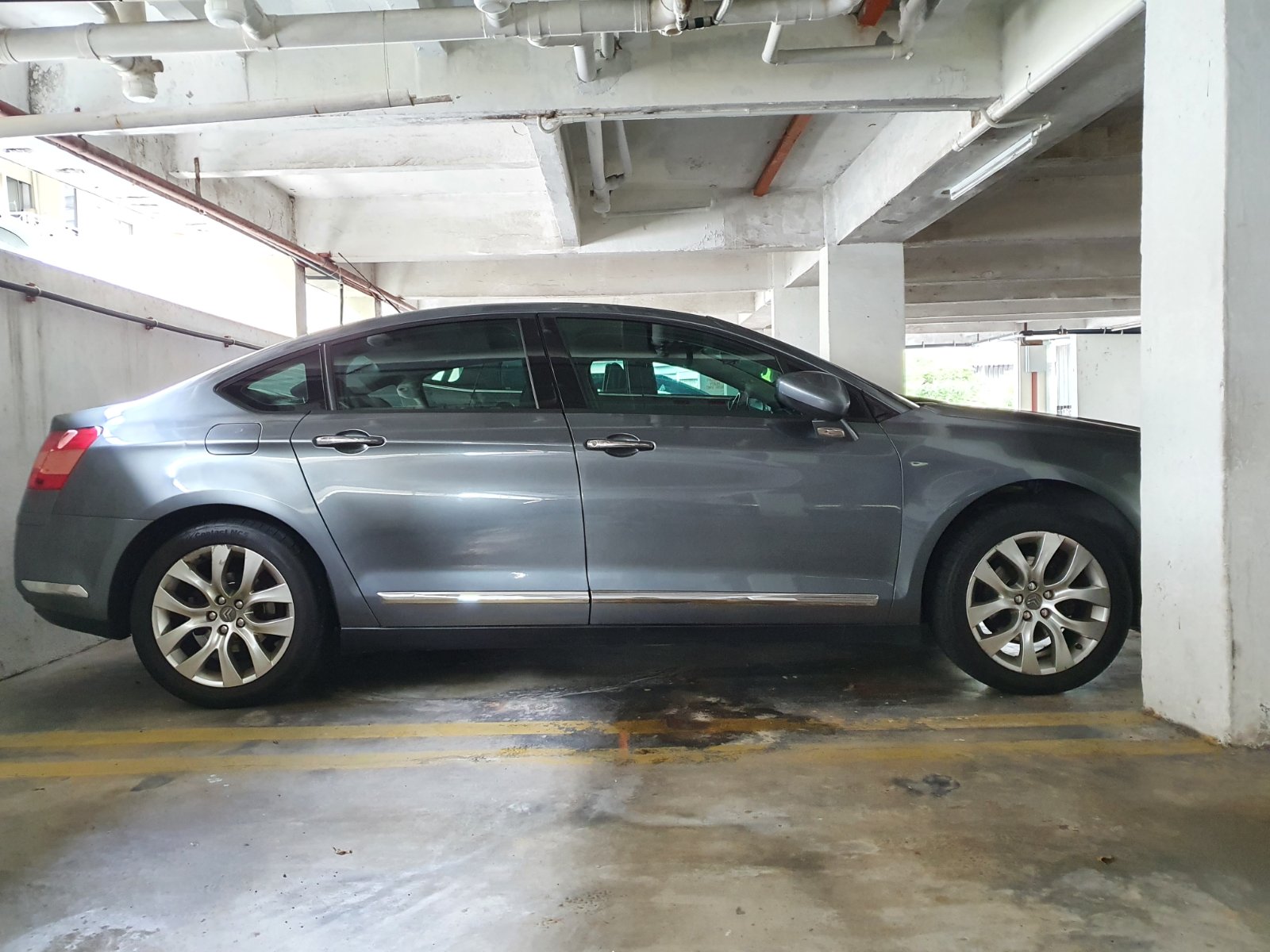

Hi everyone, I've recently replaced the front shock absorbers on my C5 x7, they are the Hydroactives ones.
I feel like the front is now sitting a tad bit higher than usual, wondering if it needs some sort of adjustment for the ride height or it's normal like that?
Thanks everyone!
Pictures for reference:
Citroen C5 x7 ride height

Re: Citroen C5 x7 ride height
Find the clamp on the anti roll bar for the height corrector linkage.
Slacken the bolt off slightly and tap the clamp round the bar a fraction until it the ride height looks about right.
Best to do this on a four poster ramp though to avoid the risk of squashing yourself under the car.
