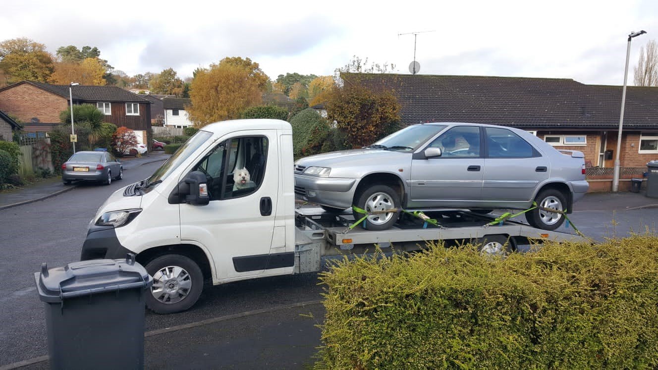

My pic - i own the copyright
I am a lucky sod... my recently bought Activa on way to garage for recommissioning after 8 years in storage. I will get better pics when i get a chance
On first "prod" by my mechanic it seems to be in remarkably good condition. It will be getting a full service, all fluid change, all belts changed, discs and pads all round, new alternator, two small leaks in the suspension system fixed (luckily easy fixes) and 4 new tyres. Which brings me to my question -
I really like Uniroyal Rainsport 5's but they are not available in 205 60 15. What is the recommended tyre for the Activa these days?
