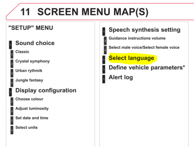

So SETUP button, then you'll need to find you way around there as per the manual:
Look for 'Choisir la langue' or similar.
