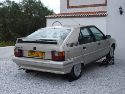

Well, the BX has arrived, traillered 1500km from France by a friend, and it's now with us.
So seems like a good moment to start a blog...
It's a September 1992 (RP 5800) BX19 Millésime, XUD9A, N/A, with A/C, LHD, in light gold (champagne).
Has covered 170k km (106k mi), which is pretty gentle stuff for all those years. Almost everything on it is original, and it has obviously been well looked after: no rust, and only one small ding on a front wheel arch, and no fluid leaks!
My guess is that the car has been sat garaged for a good while. Although the inside and bodywork have obviously been valeted, and the underside steam-cleaned, a few interior nooks and crannies (eg under the headrests) had a decent layer of dust. Interior is two-tone grey velour, dark charcoal dash, and in lovely condition, as are the seats and boot.
Tyres are passable (or maybe not) - some Uniroyal Rain-somethings at the FF, and Michelin Energy at the RR. They'll all get replaced with Michelin.
The car is drivable, and after a brief road test in France, I did the 4km local road hop from our village (where the trailer decanted it last Friday), but putting it on Spanish plates, and insurance (with temporary green plates), are still to be done.
Now, I say drivable, but the short trip from the village was a tad nobbly :shock:. All the spheres are genuine Citroen, but obviously in need of regassing or replacement. Even the Accumulator had seen better days, with the pump clicking away every few seconds.
So that was job #1, pretty much. All five spheres got removed and fitted with Valprex valves. The Acc was shot (ruptured) and replaced with a spare XM Hydractive centre, and gassed to 62. Incredibly, all four wheel spheres were the correct ones, but had not a lot of gas left in them, but just enough to try regassing. Looks as if this has been successful, as I now have lots of lovely give FF and RR, and the pump is only clicking once every 30+ secs. We'll see...
