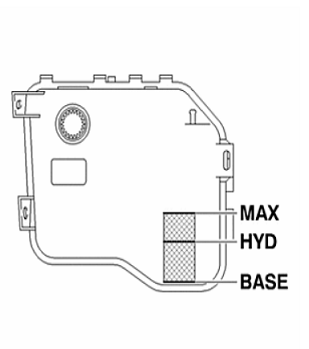

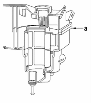

Did you actually bleed the system after changing the spheres?
Flat ground, remove LDS cap, suspension on lowest setting with engine running, then make 10 SLOW turns, lock to lock (without holding the wheel at either lock).
Then return steering wheel to dead ahead, switch engine off and check LDS fluid (see below).
If there is any 'fizzing' or bubbles, allow these to dissipate and repeat andther 5 turns of the wheel lock to lock.
| " a" : LDS fluid minimum level. If the level is below the " a" mark, add 1 litre of LDS fluid. | MAXI mark on the LDS fluid reservoir. LDS fluid maximum level: Hydractive suspension 3: Reference BASE Hydractive suspension 3+: Reference HYD |
