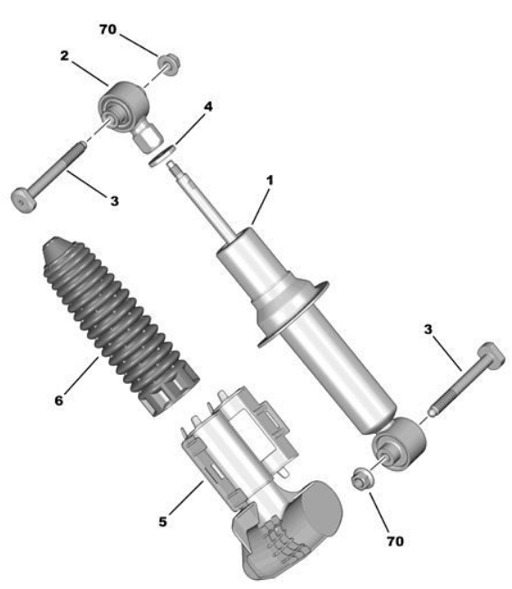

OK. Now its time for the rear shocks and springs. Just did the front and I'm getting noises now coming from the rear that to me sound like the bushes of the shocks getting worn. A kind of squeak, groan, thump.
So is there a detailed 'How to?' to do this job and also is there a parts diagram of the spring and shock for this car. I need to know if the top bearing/bush is a separate item to order.

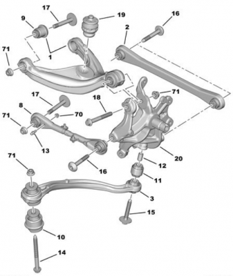

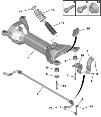

If you need part numbers for anything, let me know the table (A, B or C) and the item number(s).
Procedure can be found in the Resources section:
C5 X7 Metallic Suspension Rear Damper Replacement

Table A No 2 and 4
Table B No 14
Thats all great, thank you again

Ok so:
Item (2) Part: 522074 Rear Shock Absorber Eye £23.62
Item (4) Part: 522439 (MUL) Plain Washer £3.78
Item (14) Part: 516533 Rear Spring Upper Cup £16.51
Prices from Citroen as of today inc. VAT
