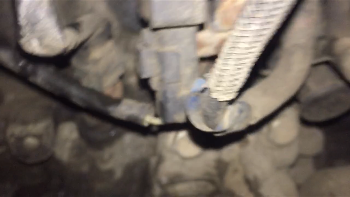

Is this the crank sensor?

The Crank Sensor is normally on the crank pulley end on the DV6 engine & its usually a 3 pin hall effect type. From memory is sits at around the 8 o'clock position behind the crank pulley.
