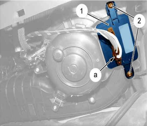

My ds5 1.6 blower heater burnt out I have replaced with another ,including rectifer and wiring harness switch light up on dash but blower is not working I hvae run power direct to blower and it works Is there afuse or relay i have to check? Mike

I have a 62 plate Citroen DS5 1.6 diesel and I have recently had to change the heater blower, rectifier, and wiring harness due to the original catching fire. The blower switches light up in the cab but the blower does not work. The switches on the dash light up and I have subsequently ran a direct power cable from the battery to the blower which works. Is there a fuse or relay I need to replace if so where is it. Thanks. Mike

That will likely be the blower motor control module. You can see it attached to the blower motor as shown in blue.
