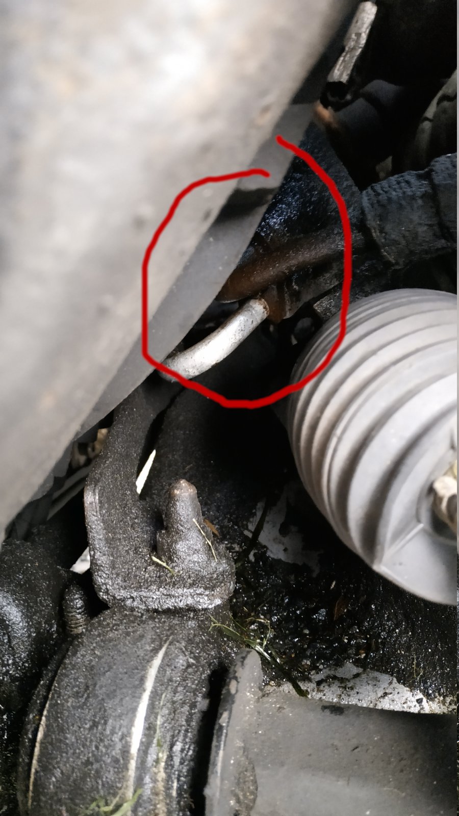

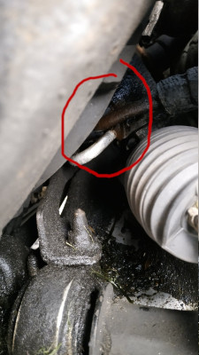

The power steering seems fine, but the reservoir is empty and there is a puddle on the under tray at the drivers side wheel.
The leak seems to come from above the red circle and is dripping at the bottom of silver pipe.
D'uh me - it is the pinion seal. I'm guessing I'll need a replacement rack, how much are the reconditioned ones?

Removing and refitting the rack is only part of the problem, the continuing pain in the rear will be trying to seal up the old power steering pipes once you've re-attached them to the rack. They don't like being disturbed and should really be regarded as single use.... and replacement ones are getting hard to find. <Sarcasm mode : ON> Just one of the perils to be expected from running such ancient cars. <Sarcasm mode : OFF> :roll:

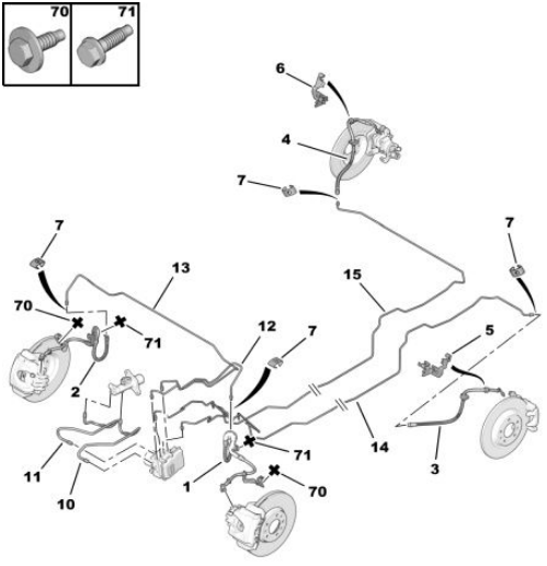

What should the drivers side brake hose look like? I've been told it was installed backwards, but I think it's more likely the wrong one.

Here is the brake piping:
Let us know which item numbers you suspect if a brake pipe / hose and I can advise of part number.
