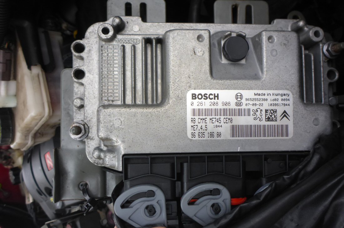

Re: ECU version compatibility and firmware updates sources
Unread post by captainkephart »
Hi Marc,
Thanks, very helpful. Didn't realise it had to be the whole set.
The numbers you give don't seem to tie up with what I have ... see photo. Maybe I'm just being dense?
Captain K
PS: sorry, links were for other members to follow if interested - didn't expect you to read them!
:oops:
The secret of happiness is freedom - and the secret of freedom is courage ...
x 6955
Ok, so I just double checked and there is some slight confusion if this is your Xsara Picasso VIN ending in 549.
There are several possible injection variants fitted to this engine:
Bosch MP7.2
Bosch EDC15C2
Bosch ME 7.4.5
Bosch ME7.4.4 or ME7.4.6
Magneti Marelli MM6LP or MM6LPB or MM6LPC
SAGEM S2000 or S2000 PM1 or S2000 PM2
So I've removed the EDC15C2 reference in my previous post to avoid confusion.
So looking at the date on the injection ECU, I can see that you have the Bosch ME7.4.5 as listed above - and the year of manufacture (22/09/2007) would correspond to being near your actual vehicle build date of (16/10/2007). So I suspect this is the original and one of several variants they could of used for this TU5JP4 engine.
