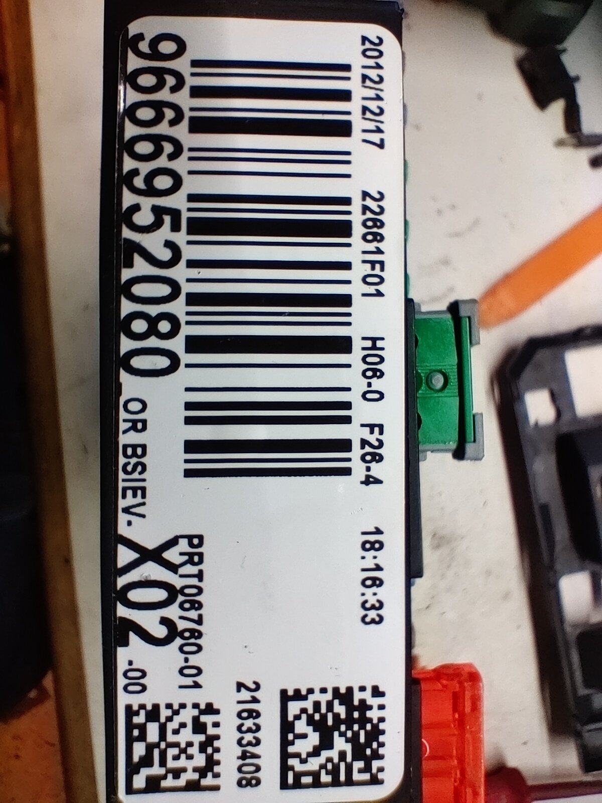

Anyway, the two left doors (passenger side in the UK) don’t work anymore. My car is LHD (Norway) so one of the affected doors is the drivers door. Using the key, it opens/locks the two right doors and the boot, while the left ones don’t react. Mirrors fold/unfold and turn signals confirm. Same deal using the remote / key FOB.

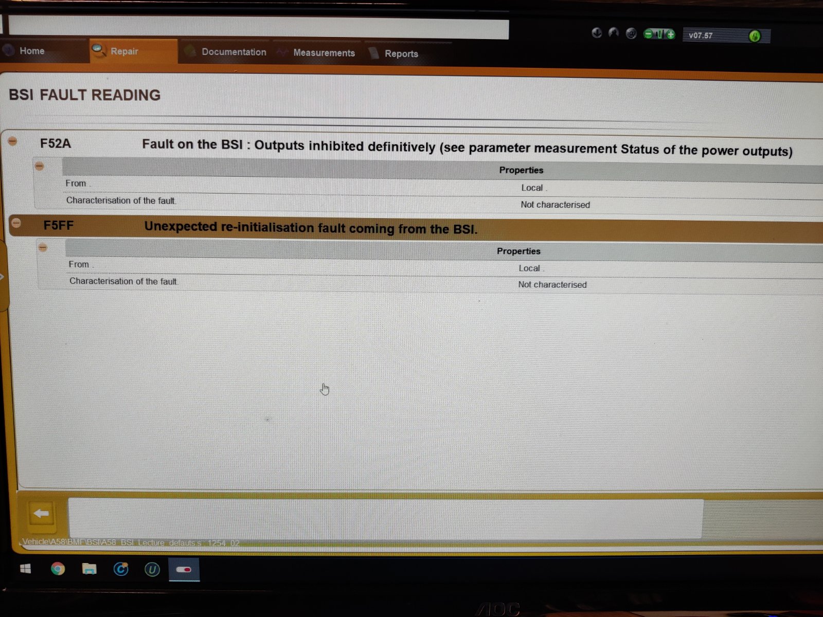

I’ve got two faults in the BSI: F52A & F5FF (see picture).
F5FF will erase, but it comes back. F52A won’t erase at all.

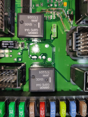

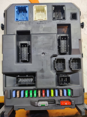

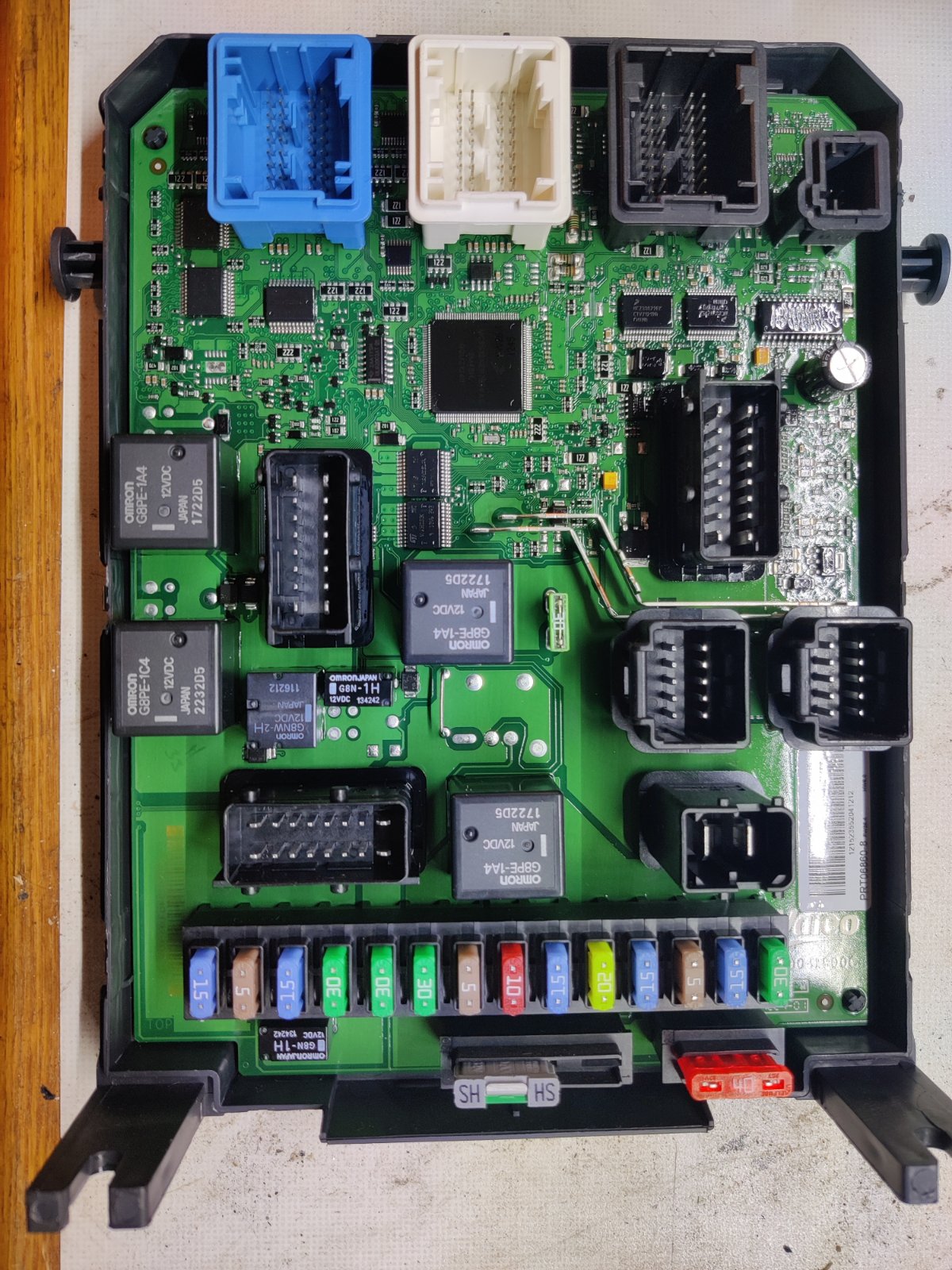

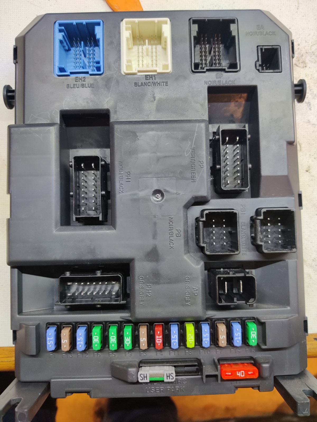

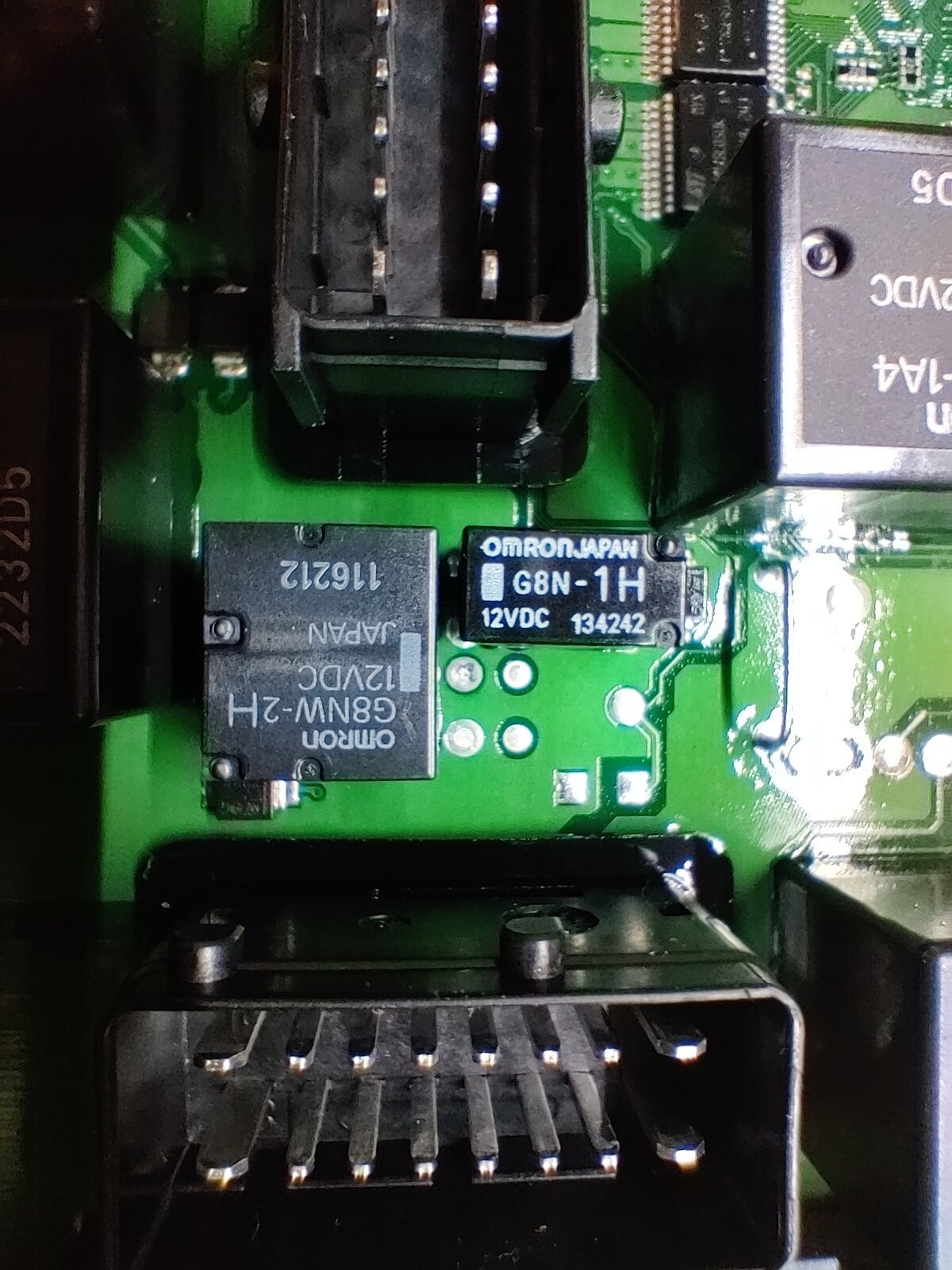

I pulled the BSI and checked all the relay coils and the resistance values are all consistent and seem fine. I’ve reset the BSI multiple times but still have the same issue. All fuses are OK, including the one soldered to the board of the BSI.
Does anyone have a clue what’s going on?

The F52A is the main one - as it says, there is a problem with communication / power. I would first check the obvious - the loom between the door to the bulkhead that carries all the wires - these can become brittle and crack through opening and closing the doors and of course, the driver's side in your case is going to be the most used and the likely culprit. There should be a grommet protecting the loom that yiou can remove to see if there is anything obvious, then checking back.

Personally I believe it's the BSI.
Both LH doors failed simultaneously, and I have a hard time believing this is due to wiring. Considering the car is 2013 wiring shouldn't be that brittle yet.

Well for a start you can see from the diagram that each side has a separate earth point, so that is something to consider. It could also be a relay internal to the BSI. Also check Fuse 2
