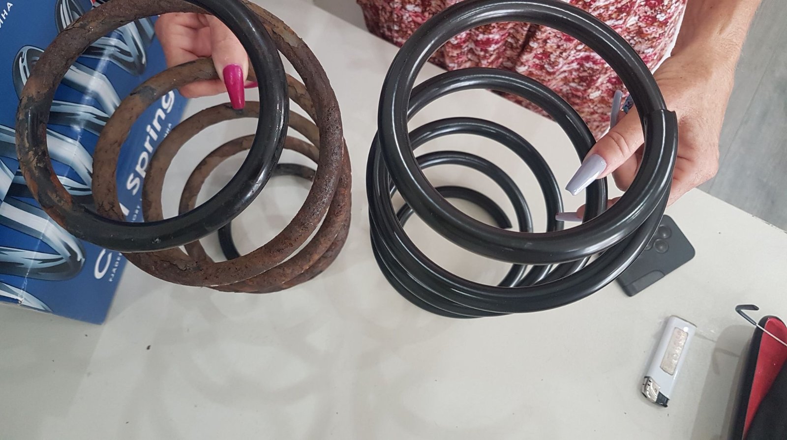

Hi All,

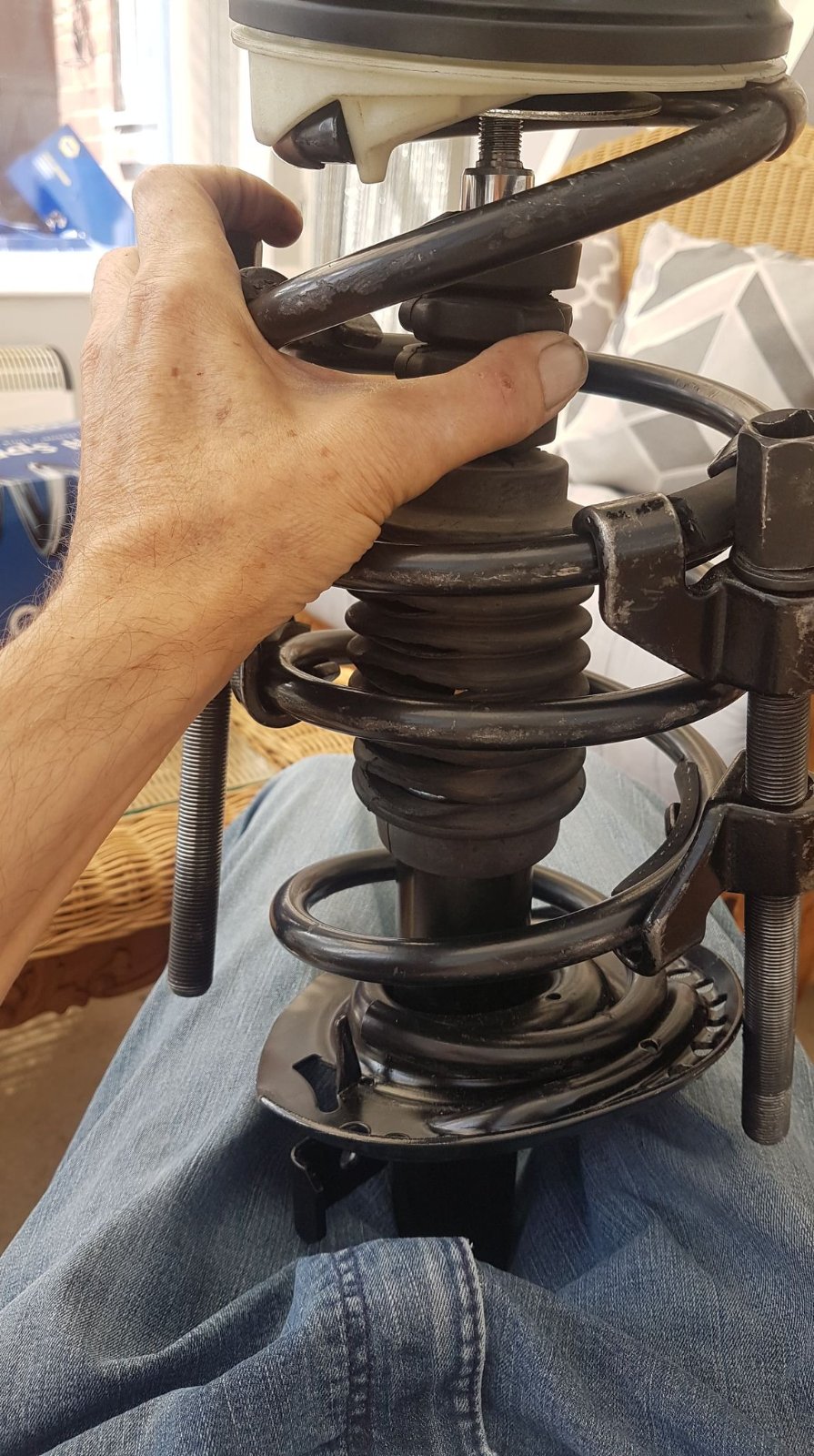

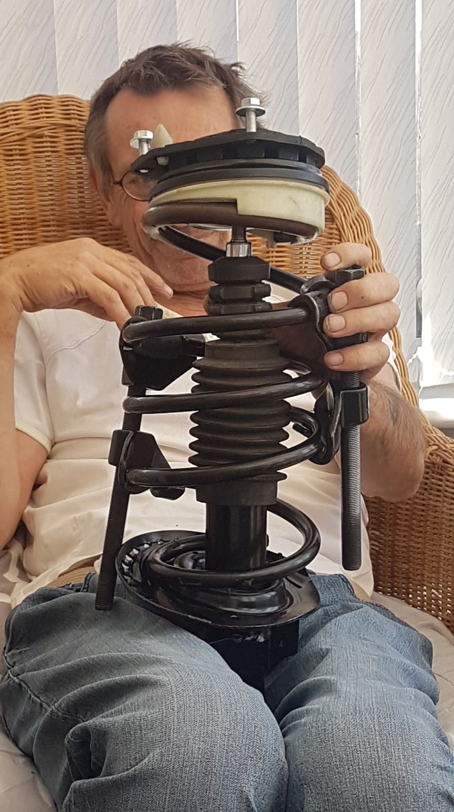

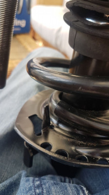

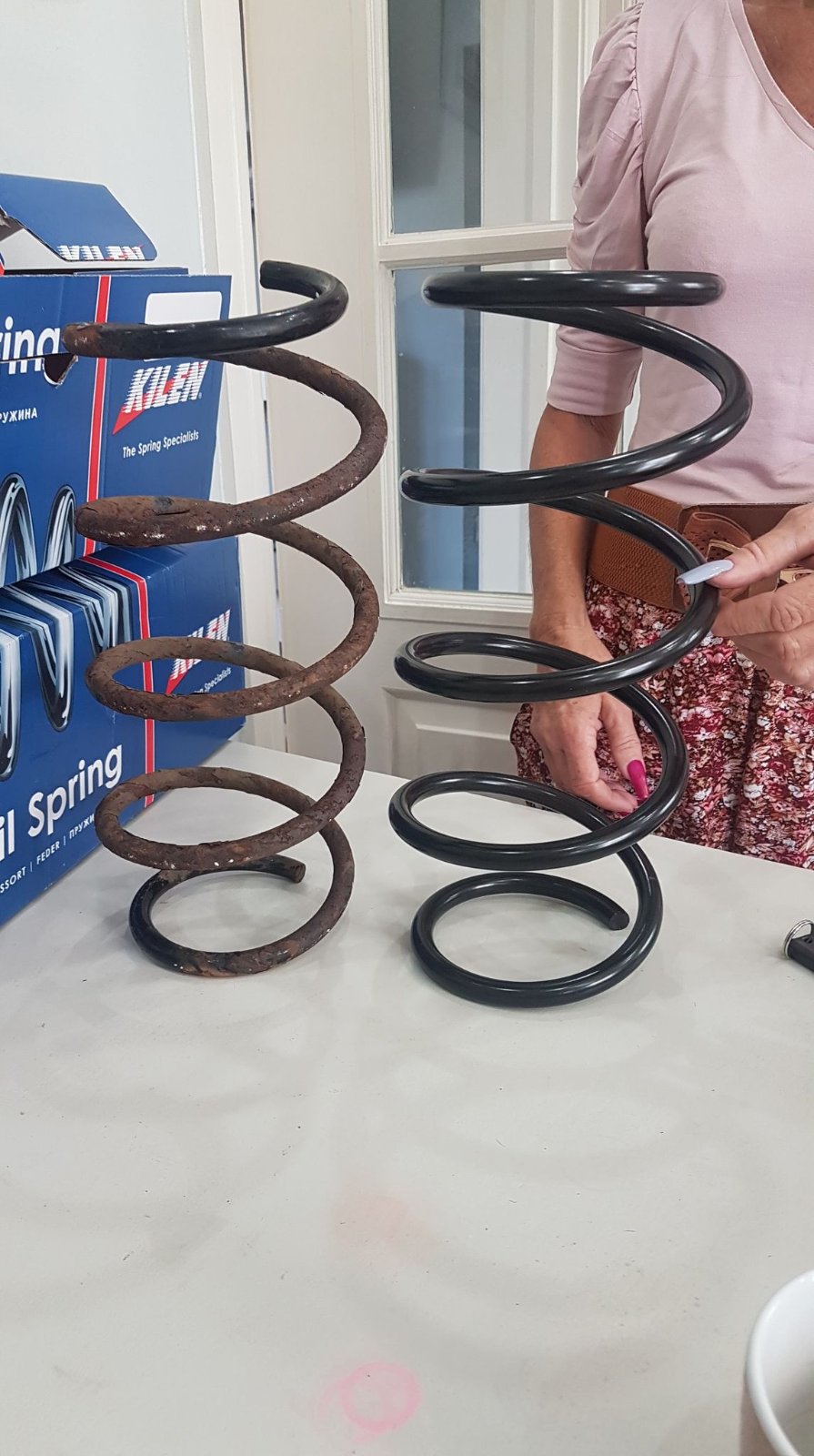

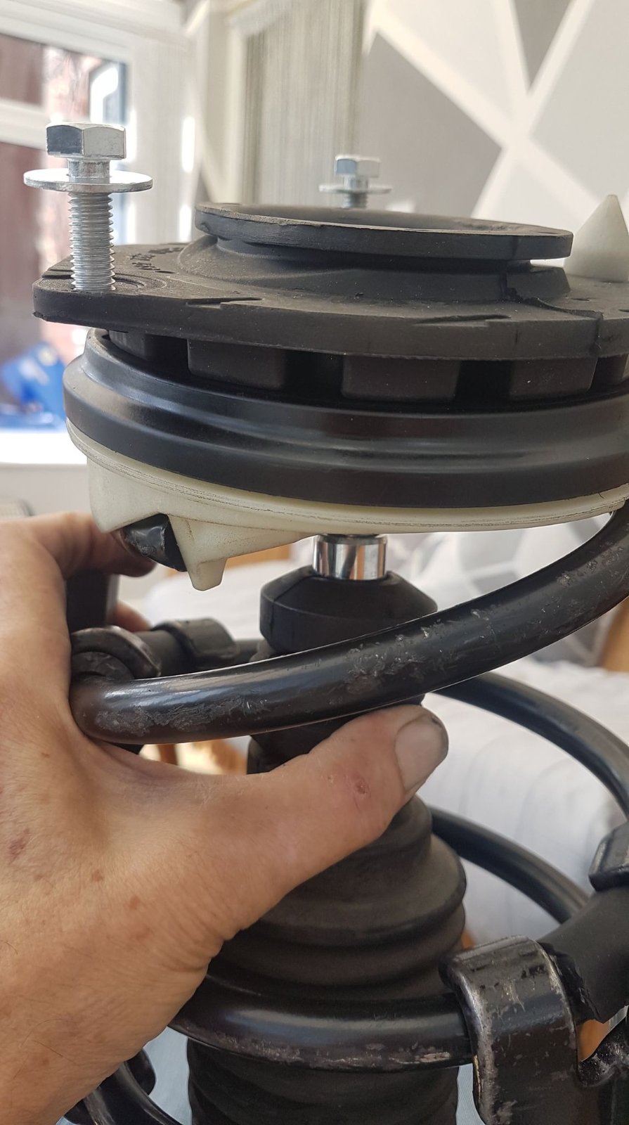

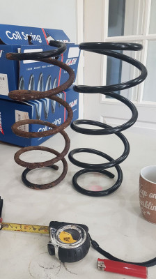

Hope someone can help. Purchased 2 new Kilen front coil springs for the above Scenic (106 hp). but they do not seem to fit the strut. The lower pig ear end lifts from it's stop when I try to move the damper strut into the top mount and the whole assembly seems to be at a weird angle. I have searched Dialogys and the part numbers listed cannot be found anywhere on google (8200304217 or 220,224,227,231,236,238 and then 8200348818 or 818). Have I been supplid with wrong springs or am I dumb and doing something wrong? Pictures attached.

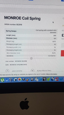

Have attached details of Monroe spring that looks the same as original. The ones I have purchased are bowed but these are straight
Regards
