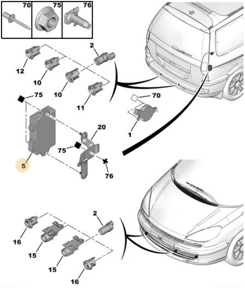

Would you know where the parking ecu is on a C8 ?

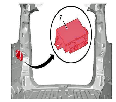

Here is where the ECU is located. Item (5), located on the inside rear right wing, probably behind the trim or storage compartment / rear wing light cluster area.
Better picture here:

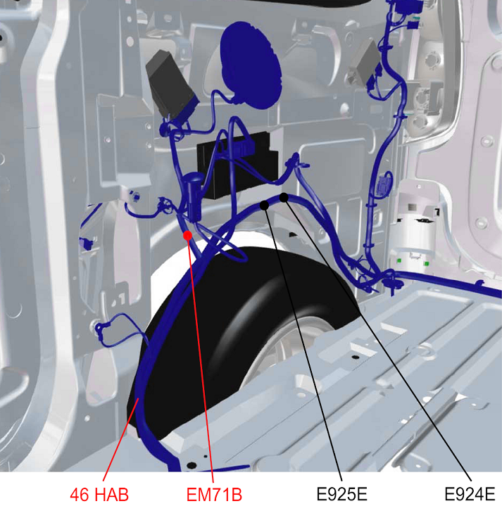

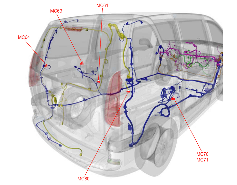

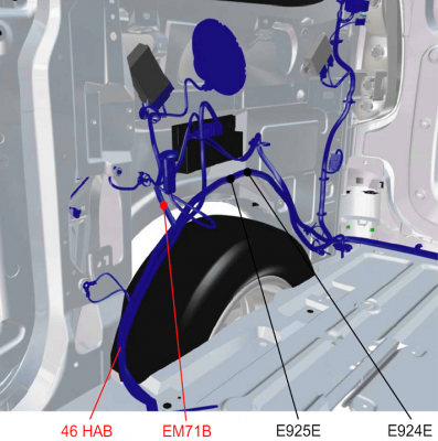

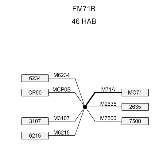

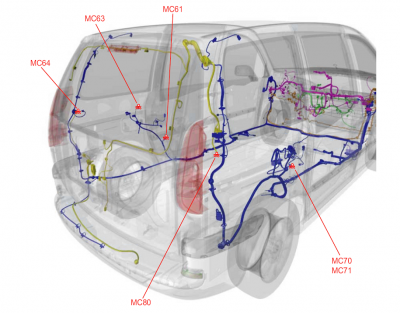

It's very unlikely that all 4 rear sensors have gone - so I suspect it is an intermittent supply fault that is causing the 4 fault codes each for the individual rear sensors to show up. As it is all 4, I would ignore the sensors to start with as it is highly likely to be the Parking Assistance ECU or the wiring to or from it.
All these faults indicate an absence of the negative - so I would suspect the Earth is the culprit.
ON your Parking Assistance ECU, there will be an 18 pin black connector and a 12 pin blue Connector. On the 18 pin connector, take a look at pin no. 1. Which is the common earth supply for the ECU and subsequently all the sensors.
There is only one earth for the ECU and this is Earth Point MC71.
Now looking at the location - it is hard to tell exactly where it is from this picture, but it does seem to sprout off the main right loom as you can see:
Click Image to Zoom Crimp Point EM71B would seem to collate the earth supplies from various kit
So somewhere EM71B will branch off to the actual Earth Point
So as the other Equipment that shares the same Earth Hard Point that is assumed to be working, maybe it is the specific earth wire inside that loom that has a problem?

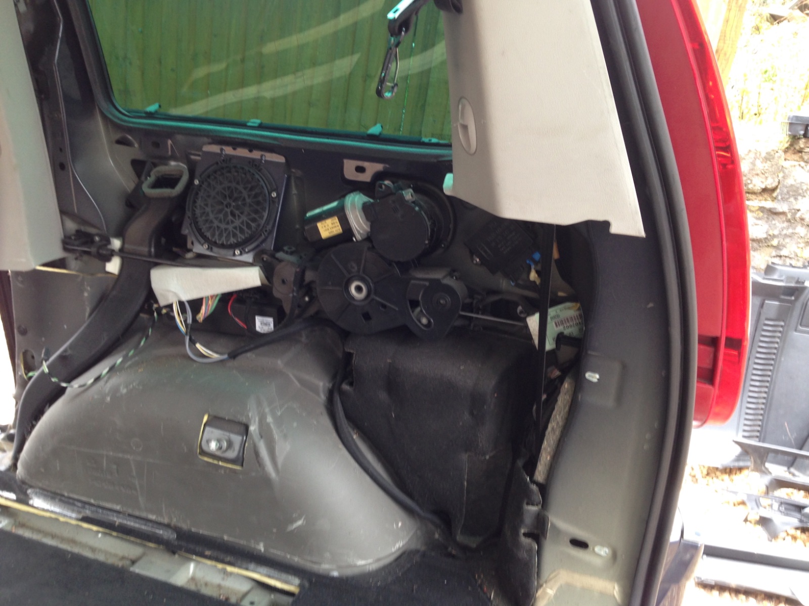

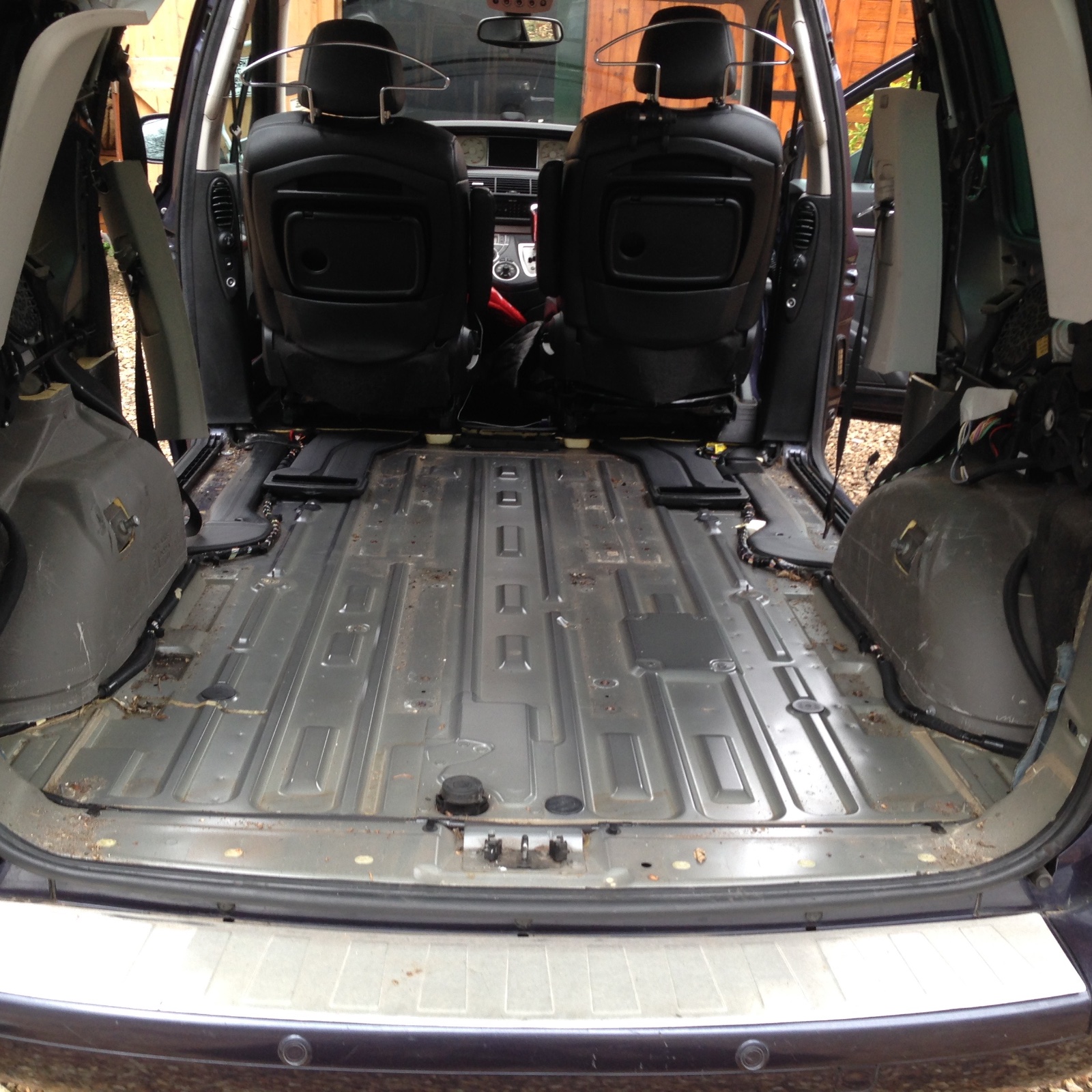

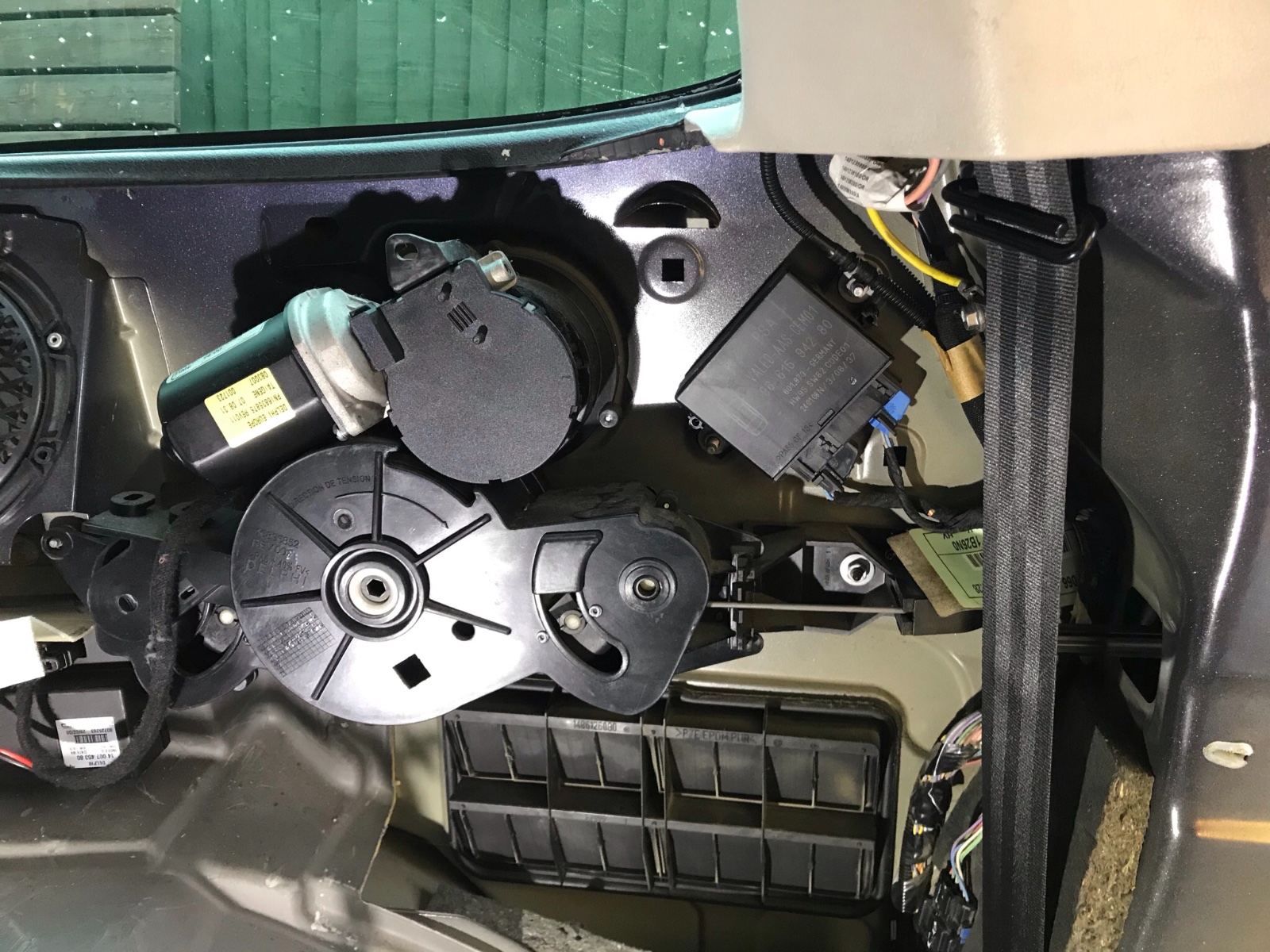

Just found my pictures and thought I’d post it on here just in case it’s ever of help to anyone else - although I don’t think there are too many C8 owners on here.
Just remembered, that my rear 12v outlet doesn’t work either - maybe I should double check all the other items you mentioned Marc !
Cheers
Julian
[attachment=0]
Cheers
Julian
[attachment=0]

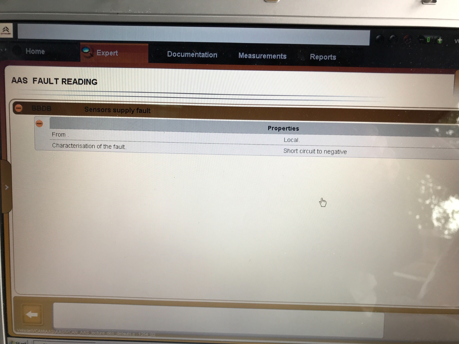

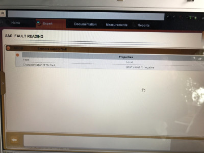

Well, I spent much of today pulling out the interior rear of my car and everything was just as you described it, thanks so much Marc. It’s amazing the lengths PSA have gone to to conceal fixings for aesthetic appeal, however it means you often have to remove another component to release the one you want to remove - and sometimes even remove yet another to release the second one !!
Unfortunately, after a few false hopes, I’m afraid to say I’ve failed to fix it. When I got the quarter panel off, I immediately saw the ecu and disconnected the 18 way connector you described. I then noticed that the other one appeared loose and I thought that could be a problem but then I realised that I’d probably dislodged it accidentally myself. Later I detected a little bit of damp and thought that maybe water ingress was causing the problem, as you’d suggested earlier. However I removed and opened up the ecu and it was bone dry with absolutely no sign whatsoever of any water ever having got into it. It transpired that the water was from the rear washer tube and couldn’t have got near the ecu anyway.
The apparent clue that the 12v outlet wasn’t working turned out to be another red herring as it transpired that I hadn’t reconnected it when I last had that panel off. Oops !!
I checked terminal one of the 18 way connector (How on earth do people get probes into those connectors ?? ) and it was a good earth. Nevertheless, I spliced into the lead and added another good earth to be on the safe side. I found the MC71 earth point and that looks good.
Checking it then on Diagbox it just showed ‘short circuit to negative’ although nothing to point to the rear sensors like before.
Maybe I should check all the other wires into the two connectors ? And, again, I’d just ask how anybody manages to get a probe or some such into there.
Because this all started with the front sensors (the rear ones have always worked perfectly) I pulled the front bumper off just to check the connections and that I hadn’t made any mistakes (like I had with the rear 12 outlet !)
Any other thoughts or advice would be very gratefully received !

If the circuit has been tested with a new earth to pin 1, and the ignition is on and it is still not functioning, it is possible that the fault is internal to the ECU. This may be a cracked small dry solder joint for example, that would be hard to detect visually.
