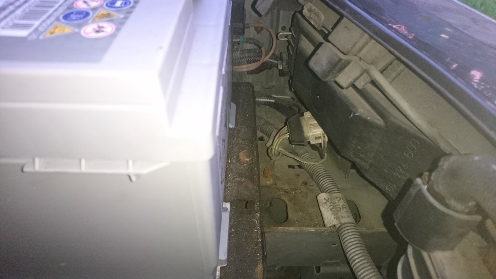

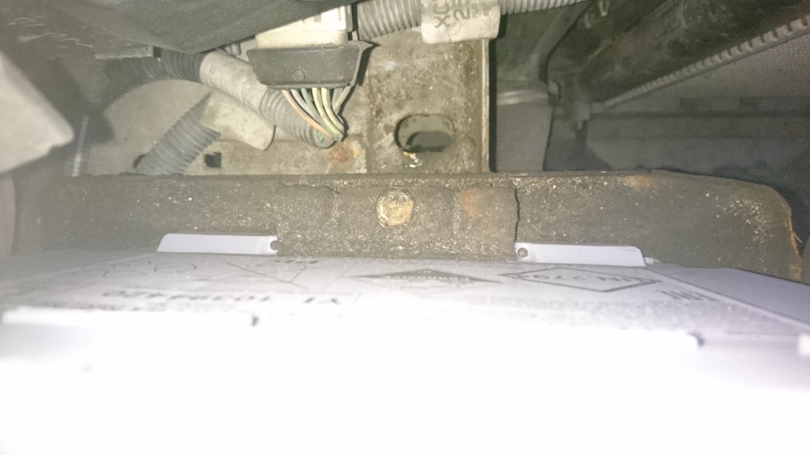

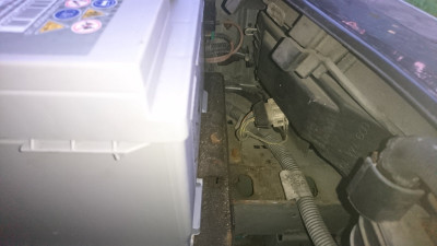

Just thinking, there is a post at the beginning showing the overheating problem where the copper positive cable enters the lug. The attached picture shows the standard arrangement and you should see that the battery can be lifted straight out once the electrical connections etc., are undone and put aside. Nothing else needs removing.
If you can check that picture out it may solve your conundrum.
Hope that helps.
Andy.

Re: Re: Xantia 2.0 hdi estate battery
It's page 7 - Check your Positive Battery lead...........
There is enough there to identify the arrangement
Andy
