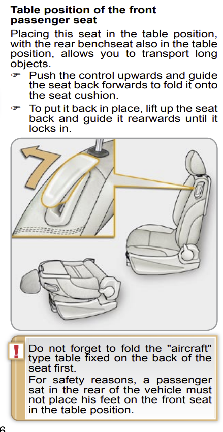

Re: C3 Picasso Front Passenger seat - won't/should it fold flat?

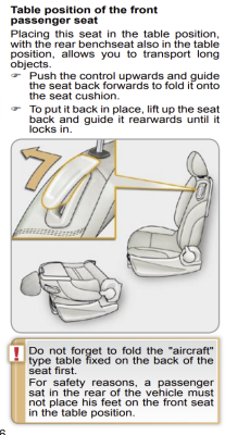

From the manual Jim:
Posts: 55151
x 8422
That's a shame Marc, mine doesn't have that :(
x 6946
I've just checked with Citroen and the C3 Picasso was available with 2 options as suspected:- one with folding passenger seat and one without, so the manual has omitted to mention the 'optional' bit! :roll:
