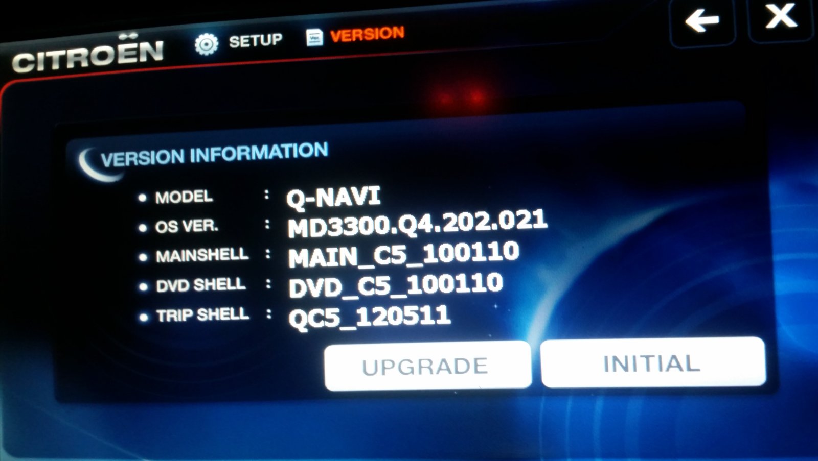

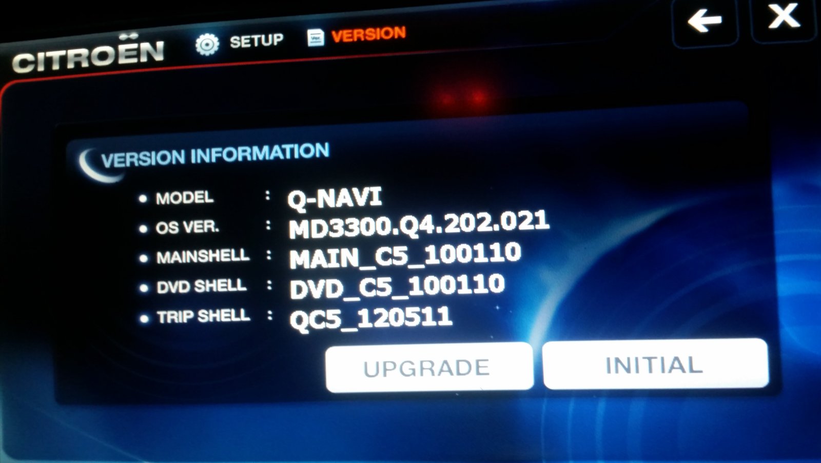

Re: How do I identify what system I have
Hope that helpPaul-R wrote: 26 Aug 2020, 13:48 If you could post some photos it might be possible to identify it from that. Photos showing, especially, some of the menus.
- x 6960
As I mentioned in my PM to you - that is not a PSA model - it's some aftermarket Android thing that has been retrofitted - as your original system was an RD45 with monochrome screen. None of the PSA units have that screen or info.
Secondly, the C5 X7 was not fitted with the 7" Touchscreen system until 2014 minimum and that was a SMEG / SMEG+iV2
