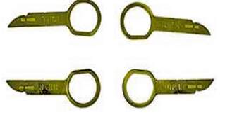

In order to remove the clock, you'll need to get one of these radio removal tools:
They can be had for a £ or so on ebay.
Then you need to insert one of the tools shown at (a) and pull it out once the catch is released.
I'm not sure of there are any replaceable bulbs on these or whether you'll need to replace the clock, but worth a look.
