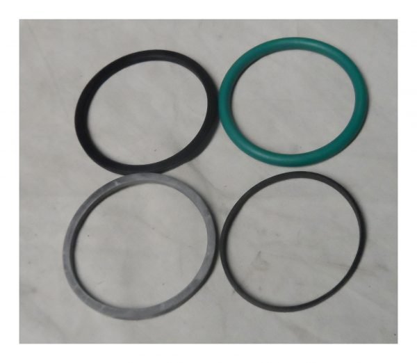

Just for info - I'll be changing the suspension gaiter and the three seals in the cylinder after picking up this kit (sphere seal also included, top right).
Is it OK to add the name of the supplier?
