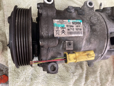

Today I decided to dismantle the old compressor to try and find why it wouldn’t engage and what was causing the rattle in addition to the reason why there was hardly any gas in the system (<5psi).
This is the compressor removed from the car, what is immediately obvious is that the coil wires have been ripped off... so that explains why the compressor wasn't engaging. At this point by spinning the pulley by hand the metallic noise appeared to be from the clutch coil rotating with the pulley!
Somehow the clutch coil electromagnet had detached from its mounting and was rotating at full engine speed, thus ripping the wires off.

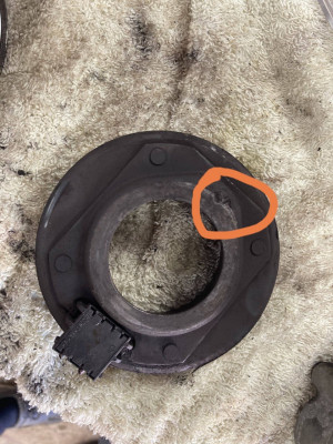

After removing the clutch, pulley and some circlips I removed the electromagnet coil and could see what the issue was. There should be a locating nub on the coil (circled in orange) that located the coil, but on this one it had been worn down somehow.
Similarly on the compressor body the holes that the nub should sit in seem worn and show evidence that the coil has been rotating with the pulley.

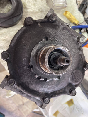

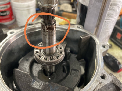

The next bit is of the autopsy is still interesting to me as it could explain why the gas mostly leaked out.
This corrosion on the main shaft lies directly where the end seal is located on the sanden and perhaps explains the leak. I also found oily residue on the clutch plate suggesting that at some point oil (and refrigerant) had left the system via this seal and dripped down.
For that reason, I'm glad i didn’t just get a new coil and replace that as I'd almost certainly have had to replace the compressor itself once I found that it wasn’t holding gas.

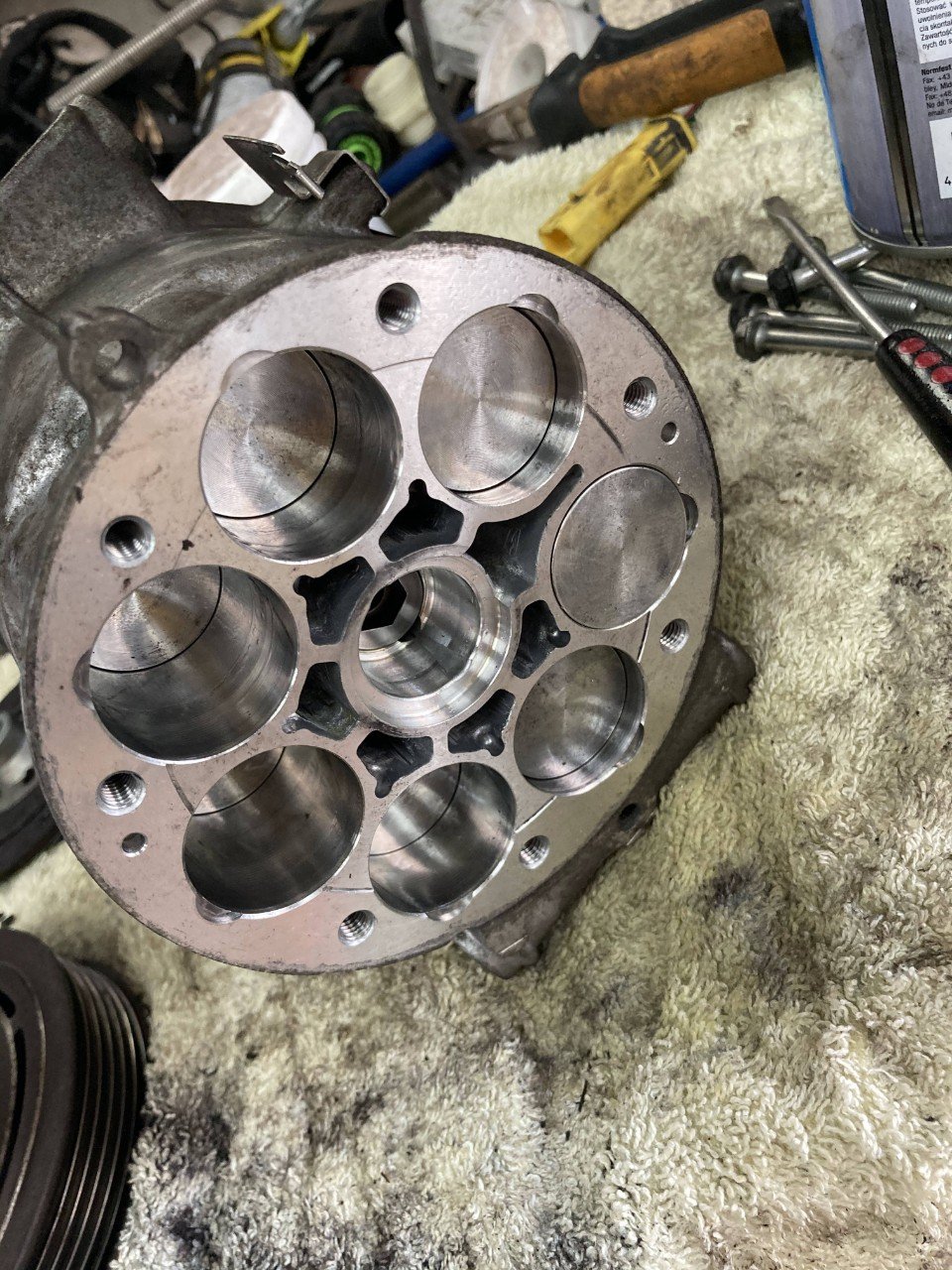

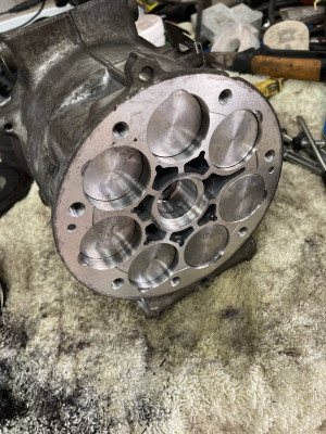

The next pics show the compressor at minimum and maximum displacement:

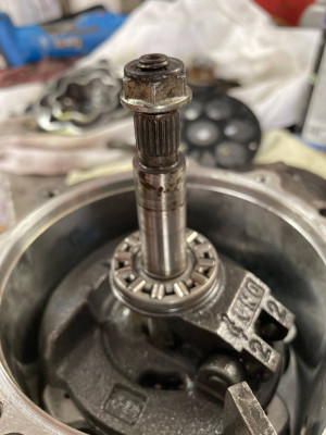

and this final picture shows the amazing piston arrangement:
All in all, these are amazing devices and barring corrosion on the shaft the rest of it was in great condition.
