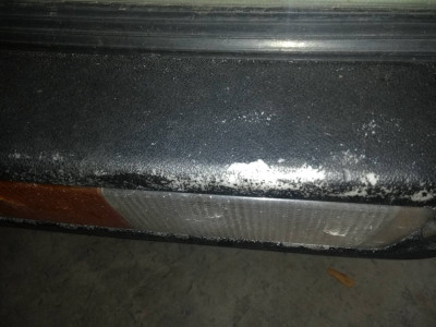

6, Lastly the black bumpers are knackered (see photos) - I understand that they cannot simply be painted to bring them back to good condition, any comments on that please? I've thought of having them restored to body colour if thats feasible but not sure on that.

Getting a body colour match for the bumpers will be quite difficult especially with those gold metallic paints.
- x 1751
Re: CX Prestige Turbo 2
There is/were some paints specifically for matt/silk/satin/gloss plastic body parts. The name Plastikote/Plasticote rings a bell.
BX bumpers were successfully painted, although originally a self-colour. Black should be straightforward.
