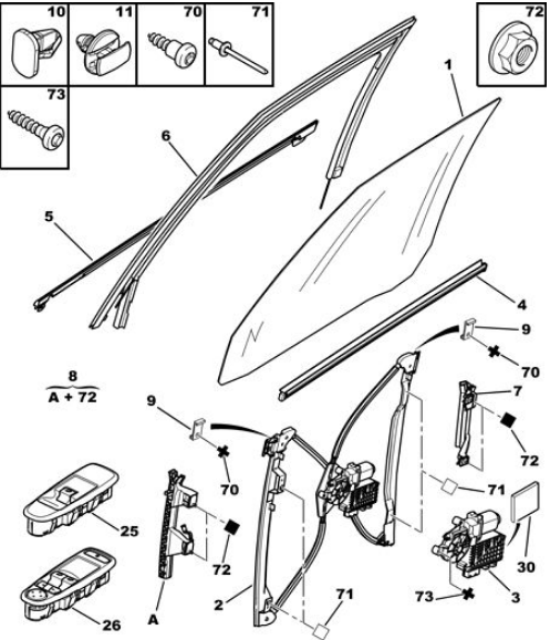

Do you mean the Driver's side electric Windows / Mirror Door Control item (26)?
If yes, part number: 6554YH, priced today at Citroen For £219.91 inc VAT.

Re: Window switch part no. pls.
Thanks, as always Marc. What is item 25?
Item 25 is for the passenger side - that just has the single window switch.

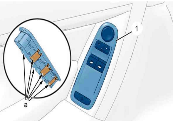

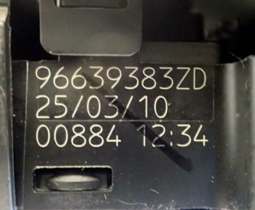

There's no user serviceable parts inside - all electronics - but what you can do is carefully take it out and take carefully take the casing off. Then inside you can use some electrical contact cleaner to clean up the board. What happens with these is that rain gets into the units and can cause some contact problems. So a good spray of electrical contact cleaner (not WD40!) can sometimes clean the contacts of the switches up. I've seen variable results with this - some will see an instant fix and others it may work for a while and they revert back. A further clean may then resolve it again.
You don't need a new one necessarily - just get a second hand unit.
I've given you the PSA part number. When you take your unit off, have a look on the side for the long international part number beginning '96********' as per my picture below. You can then source a used part using this 96 number. You just need a flat blunt plastic trim removal tool and carefully lever the plastic clips in as you lift the unit up from the housing.
If yours matches the one on picture above, then here's the link for a used one at £39:
https://www.ebay.co.uk/itm/2-Citroen-C4 ... SwPsBeMwVT
