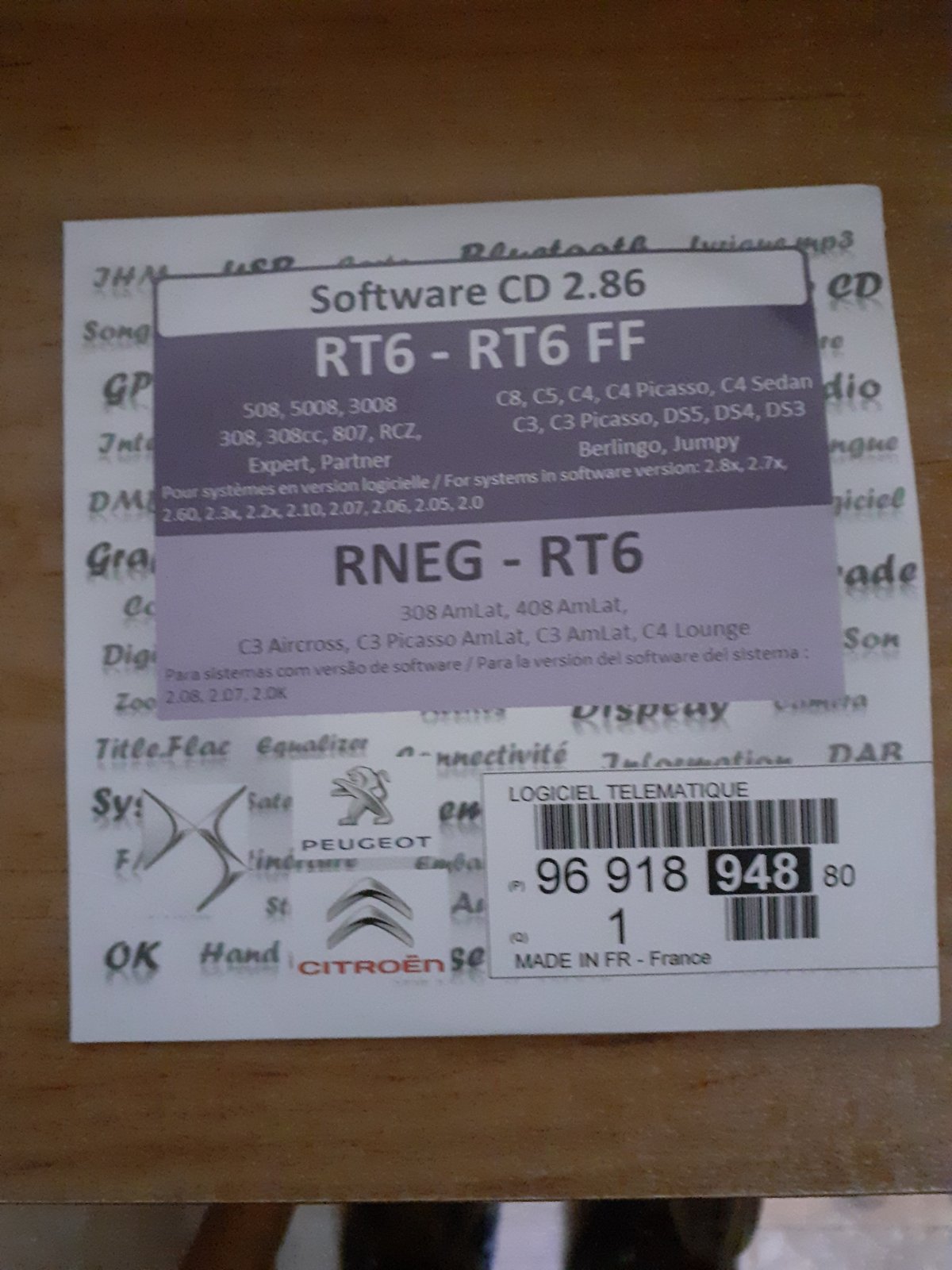

Hi here is the disk I have, I think it is the correct version, but could be wrong.
Thanks
Thanks

Ok, you have the right firmware for the RT6. However, if it has been interrupted during a previous firmware update you may find it is now stuck.
These can take a while to update from CD as opposed to a USB update. The car must be kept with the engine running during the update and no phones must be paired before you do it, as a phone call can interrupt the upgrade and if the car goes into economy mode that too can corrupt the installation. A bit late to tell you this now after the vent, but important you know this in case you can get it working for next time.
Secondly, this is a MAJOR update and if and when you can get it installed, it will 95% default your RT6 unit to factory settings, so will need a dealer to resolve most likely. The update locks the unit so it can't be configured using Diagbox either. A dealer needs to download the update via their secure servers and they can then configure it for you at the same time according to options fitted on your car from your VIN.
There is also a bluetooth calibration file that needs to be applied that resolves the Bluetooth echo experienced after this upgrade.
So all you can do is leave the CD in and then disconnect the car battery using the (BSI Reset / Battery Disconnect / Reconnect Procedure). Make sure you leave the battery disconnected for 10 minutes and then follow the reconnection procedure. Then start the car at the relevant part and see if it will start loading. Be patient though - it may take some time.
If you cannot get it to load or it keeps rebooting - make sure the CD has zero scratches or finger prints. If the lens on the reader in the car is dirty, it will make for a difficult time reading the data in.
