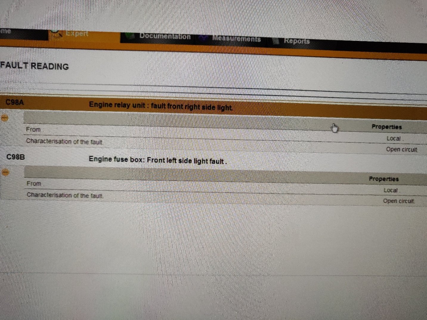

One of the faults I have not been able to clear. Lights work fine though ?!?
Light fault?

Re: Light fault?
If you have replaced any of your lights with LEDs (especially the side lights) you will get this as there is typically not enough power being drawn. If you have done this, you may need CAN bus LEDs for the side lights that have some built in resistance. Even with this, it can be enough to cause this fault. Replace with a standard W5W halogen and the fault should go.

Re: Light fault?
You are right. Could these cause any problems or can I just leave them?

Re: Light fault?
It depends really - as sometimes LEDs liike this can have other effects - like flickering or flashing on occasion - and you may not be aware of it, but it could be a distraction for oncoming drivers - so has obvious implications. The MOT may be another issue. Also, when the engine is switched off, sometimes the LEDs will glow for some time afterwards..
So either opt for some CAN bus LEDs that have load resistors if there are issues, or go back to W5W halogens.
