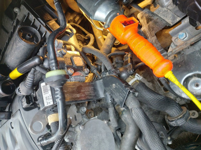

Hi I have a 207sw 2013 1.4 vti and we are trying to replace the coolant sensor but cant find it anywhere? YouTube and google havent helped at all.
Hopefully someone on here knows. Cheers in advance.

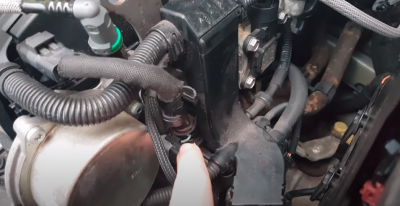

I think there were several versions of outlet tank fitted - hence the issues with not everyone being able to find it!
You can clearly see where it is on this version of outlet tank on the 207 VTi in this video - and some comments with others like you, not being able to see it.
I can tell you that the units available now do have the sensor, but I think the older units may not have had a removable sensor.
Here is the video that shows it quite clearly, from which I took the extract above:

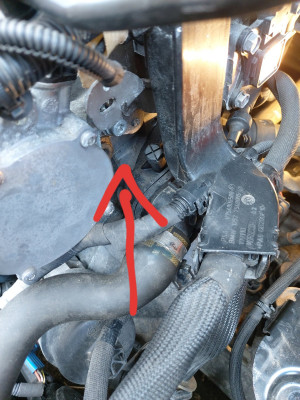

Thanks for all the info.
Since discovered it's some sort of modified thermostat
https://pmmonline.co.uk/technical/psa-t ... n-changes/
Have ordered a harness so we can swap it out for the stat we've got.
