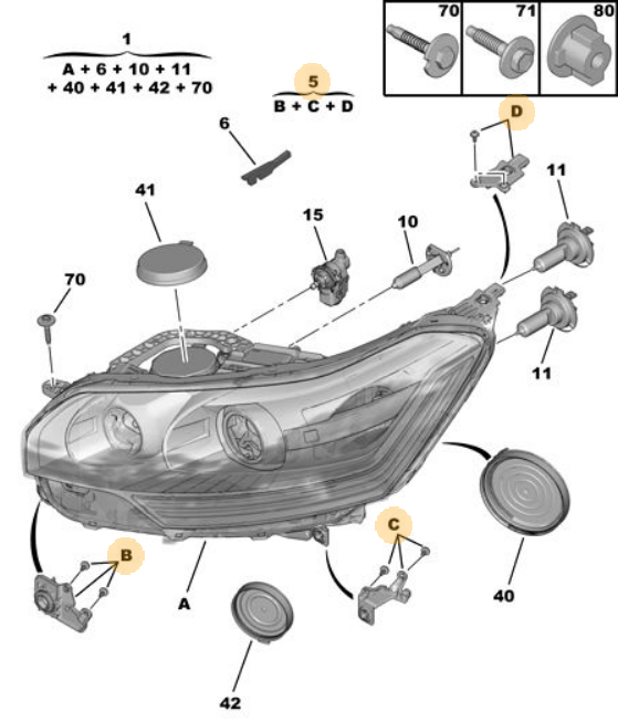

Hi,
Would is be possible to obtain the part number for the headlight bracket repair kit?. Apparently they are available from Citroen, you may of noticed they are designed to break in an impact (hence why so many broken bracketed 2nd hand items on eBay). I am missing a top bracket so intend to repair. Also, what are the possibilities to replacing the clear lens? rather than repairing a crack? i see it looks as though it will pop off with the clips being released (and silicone).

These are available depending on Left or Right hand Lamp. They come in a kit of 3 brackets, item (5), containing 'B', 'C' & 'D'
Right: 6212F1
Left: 6212F0 (zero)
These are £70.28 inc. VAT for each kit containing the 3 brackets.
