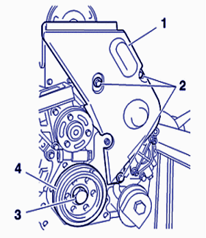

Relay II SOFIM 2.8 Timing
Tools
Removing
Disconnect the battery negative terminal.
Lift and support the vehicle.
Remove:
Refitting
Refit the accessories pulley ( 4).

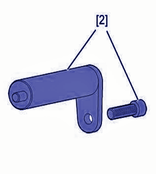

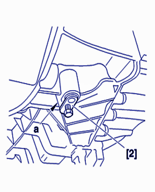

Lock the engine flywheel at " a" Using a 8 mm dia. peg.
Refit and tighten screw ( 3) to 20 ± 2 m.daN.
Remove the 8 mm diameter pin.
Fit:
Tools
| Engine Flywheel Locking Tool |
Remove:
- The right-hand lower mud shield Using tool [1]
- The engine cover
- The auxiliary equipment drive belt (see the relevant operation)

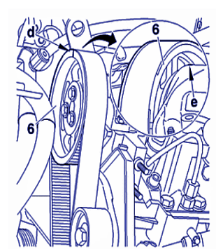

| Turn to drive the engine in its normal direction of rotation. Lock the engine flywheel at " a" Using tool [2]. | Remove:

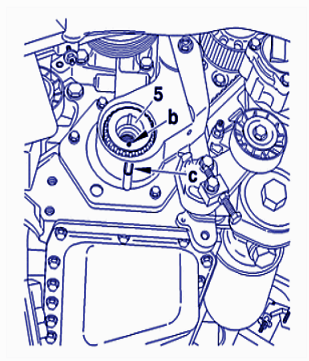

| Check that the marking " b" of the crankshaft pinion (5) is in a low position relative to the vertical axis of the engine (at "c"). | Check the alignment between the marking "d" on the camshaft pulley (6) and the marking "e" on the cylinder head cover. |
Fit:
- The timing cover (1)
- The bolts (2)
- The style cover
- The vehicle to its wheels

ok thanks, but does the tool slide into some deeper groove in the flywheel or how much do you have to turn it?

is the Tdc of the first cylinder where the sprocket markings align with the head cover and the other lower ones or where is it, and the rest of them are like 90 degrees away from eachother then?
or where does it explain how can i find the position for each cylinder...
