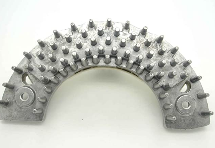

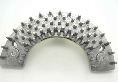

You might find that on some models the blower motor module (resistance) is incorporated into the Air Puller Motor like this:
