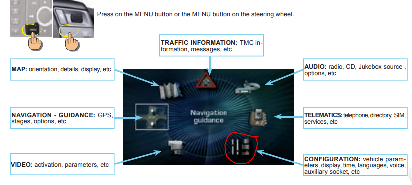

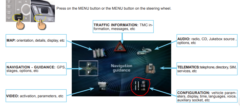

The language should be able to be changed from the unit itself. Access this screen then the configuration option I have circled in Red to change the language.

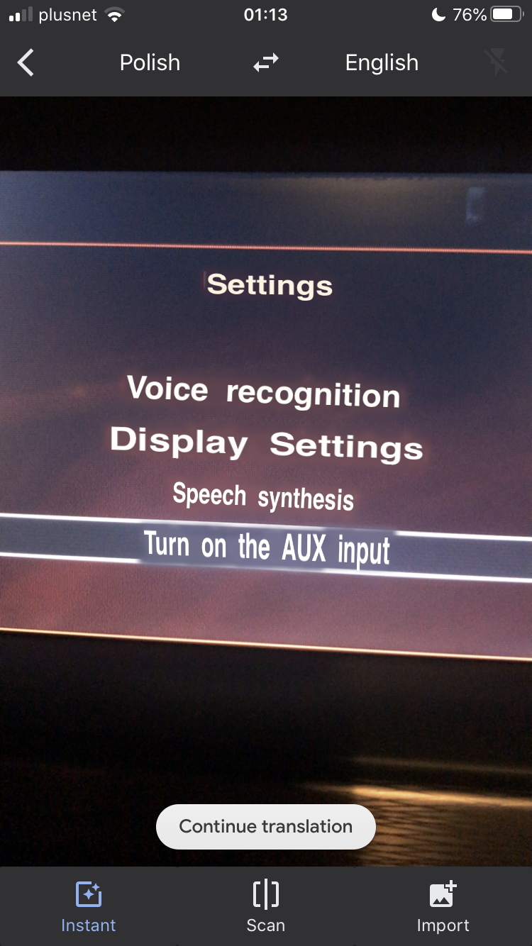

Thanks for the quick reply GiveMeABreak. I've had a look under that menu and all I have is this (google translated)
Thoughts? I removed the HDD from the original headunit that was broken and thinking of doing a HDD swap to see if that would fix it?

It looks like it has already been misconfigured at some point, probably by the previous user...
