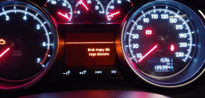

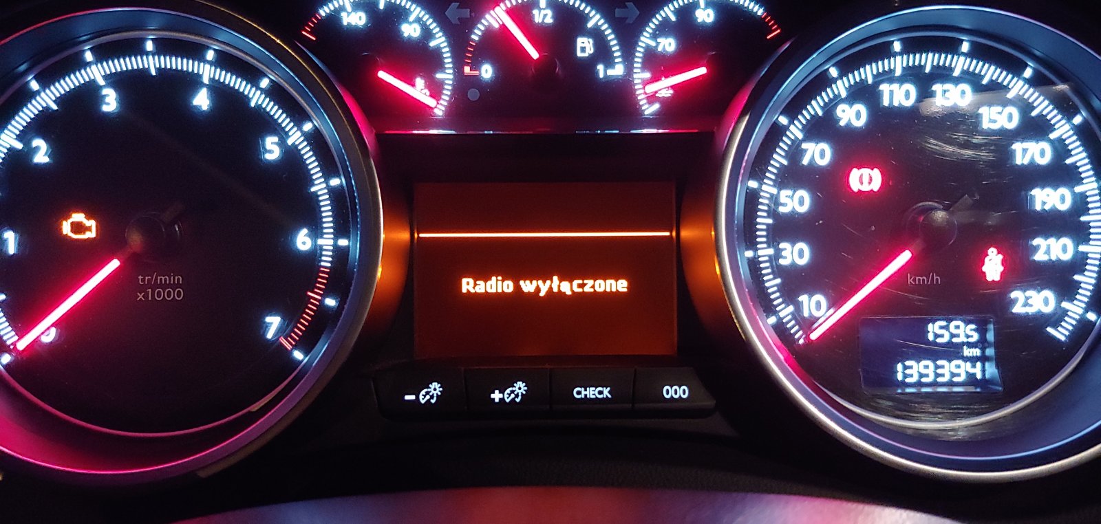

I have peugeot 508 with RT6 radio.
I updated software from 2.07 - 2.21 (for updating maps only)
after update my lcd on headunit is showing this
-"RADIO TURNED OFF"
-"NO MAPS FOR THAT REGION"
Before Update it didnt show me that messages.
Can i solve this by mirascript and data explorer ?
Or should i Update for newest firmware again ?
Below i attached a images
Waiting for any help/message

Re: RT6 Headunit problem
Major firmware updates can also reset some of the settings in the Head Unit - which may need a dealer download (secure mode) or Mirascripts if you know how to use them - but we don't support Mira scripts here because it has the potential to change a lot of settings and potentially brick your system.
Unread post by newlegolas »
GiveMeABreak wrote: 16 Jun 2020, 12:42 Major firmware updates can also reset some of the settings in the Head Unit - which may need a dealer download (secure mode) or Mirascripts if you know how to use them - but we don't support Mira scripts here because it has the potential to change a lot of settings and potentially brick your system.
Yes i know how to use but i guess i have a common problem that i can't change any vaule in dataloader program. i took all the files from mirascript from my car but then im not able to change any value is there any solution for this ?
Regards
x 6957
Only what I have suggested. There is a later firmware than that too - I think they are up to 2.86 now - but that has the same issue, along with a Bluetooth calibration that needs doing afterwards to stop the echo on phone calls after this update. Again, once applied it resets the Head Unit ECU on many vehicles are puts it in secure mode. A dealer can connect directly to the server and unlock the ECU and configure it correctly from your VIN, restoring options and functionality.
This may be resolvable with Mira, but I can't advise you further concerning that for reasons mentioned. A clone VCI with Diagbox is is generally unable to unlock the secure mode, so prevents configuring. It will keep asking for a technician login to do this and may deactivate if you attempt this.
I have an NG4 so don't have this problem thankfully.
