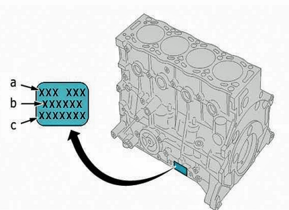

Anyone know where they hid the engine number on these engines? It's the more recent 2.2, not the older one. DW12 I think as used in various Landrover models.

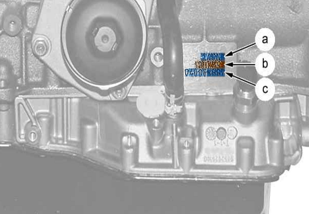

Here you go:
Key:
"a" Approved prescribed type
"b" Engine reference mark
"c" Production serial number

Thanks Marc. Nice easy to read spot! Is that the front or rear of the block?

It's the front - near the oil filter. Looks the same spot as my ES9J4 V6s.

Yes did think it was as I'm guessing the round bits on the right side of the whole engine drawing is the gearbox mount. Thanks.
