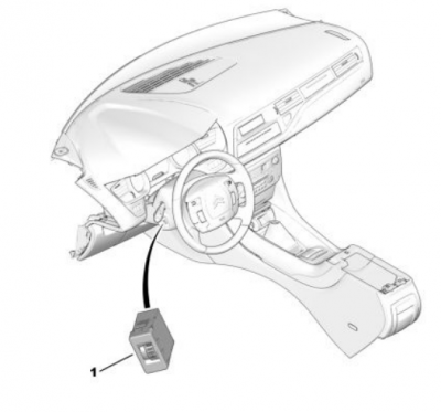

Looking to find the above to check my ongoing problem with Suspension ECU.

Hi Kenny, you don't have directional lamps, so that won't be relevant looking at the ECU for that. There is the Suspension circuit that shows the height correctors if that's what you want.
Correct me if I'm wrong, but with your Halogen lamps, you 'should' have a manual headlamp adjustment switch - maybe not as there was some confusion over this between hydraulic models with halogen lamps and metallic sprung models, but according to the VIN you have one of these switches.

Here's the suspension diagram for your vehicle:
and below is the Halogen lighting diagram:

Yep, you have the halogens not the bi-xenon directional lighting. I’ve put the right one up for you anyway.

Looking at the diagram I take it these lights are unusual symbol in the middle

Help me out here Kenny - use the reference numbers to ask me what is what if they aren't on the Wiki:
i.e 6600 is the headlamp height adjustment control (manual scroll wheel if you have this in the car to adjust the lamps up or down).
On the wiki I have listed a lot of these already, Sections 2, 3 & 4 have most of the codes in.
The list is in sections in ascending order of component code.
