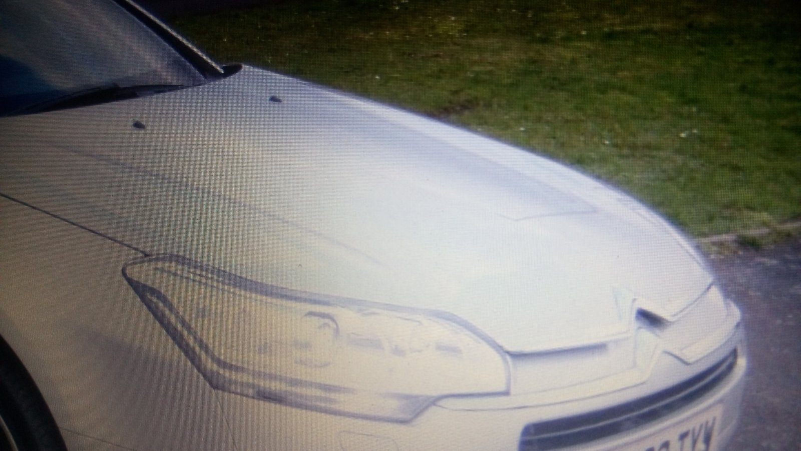

I am interested in one of these cars first registered Oct 2013.Date of manufacture Oct 2013.
To see the car would involve a long journey and although the dealer is very pleasant is not versed with important ( to be) details.
Could someone tell me the following.
Is this the latest face-lift model?

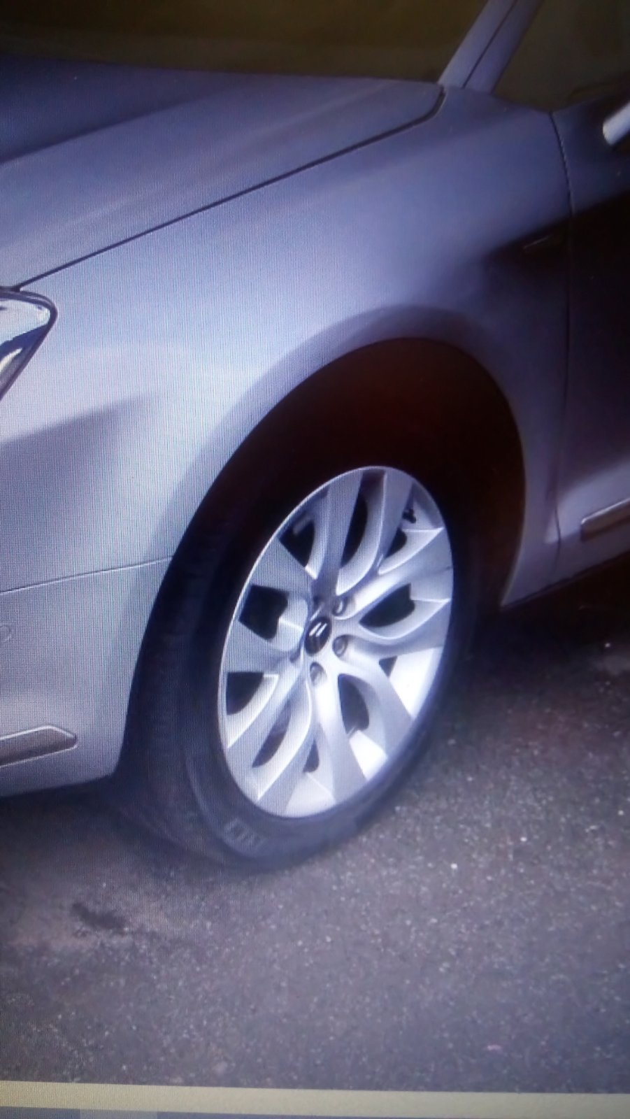

What type of wheels are they?

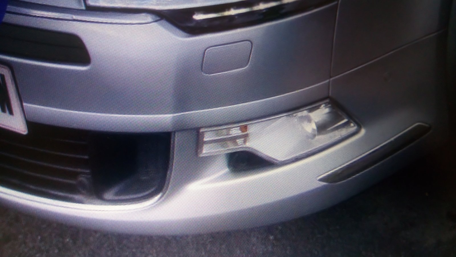

The dealer is sure it doesn't have front sensors,yet it does have xenon lights as per the 2013 spec.
My main concern is this model with a 2.2 diesel auto engine is not mentioned in the brochure.
Hopefully the pictures will help.
Some reviews I have read say t
he better ride is obtained with the smaller wheels with the Hydractive 3 suspension, yet the smaller wheels are only on the lower spec models!

Yes, this is the MK III or designated C5 X7 and is the latest and last C5 (excluding the new C5 Crossback).
The wheels are Alloys and exact size, 16, 17, 18 or 19" versions will depend on model and options. As for the driving experience, the lower the profile (larger sized wheels) the more noisier / rougher the ride is - generally speaking from others here who have said the same. I have 17" and they are fine.

Parking assistance has several options - rear only or front and rear with parking space gap measurement - again option pack equipment.
The 2.2 was discontinued from at least 2014 on, as were the 2.7 and 3.0 engined models, with PSA keeping the 1.6 and 2.0 engines in the UK at least.
If this is the exact vehicle you are getting in the picture, then yes, it does have front and rear parking assistance. The second and last pictures show the side parking gap measurement sensor on the front wing, as I have arrowed on your picture below:

The car you are looking at has the 2.2HDi engine with 200hp and was only available with auto gearbox.
Produced from 2012 to 2014 as the most powerful engine in the C5 range. It replaced the 3.0HDi and was followed by the 2.0 BlueHDi 180 auto engine.
Only offered in Exclusive specification & always with the Techno Pack (which was optional on other engined versions). Techno Pack gave it the 18” Atlantic wheels shown in your picture, Sat Nav, reversing camera & front parking sensors with Parking Assistance system, twin chromed exhaust pipes.
Xenons and full leather were factory cost options. This car also has the optional upgraded Hifi system (chrome trims in front door speakers are the telltale sign).
This car is the last facelifted version of C5 produced, with the bigger/softer chrome chevrons on the bonnet & the daytime running light in a thin strip at the bottom edge of the headlight.

Suspension/ride quality is just fine on the 18” wheels, wonderful for long distance cruising. I’ve driven other C5 on 17” & 19” wheels and there is a tiny difference (bigger wheels give slightly stiffer ride quality) particularly around bumpy town roads, but not enough difference to worry me.
